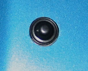

Today I painted the little hood scoop, and while I was at it I painted the windscreen squirters. I bought this snazzy little device from a craft store a while back. It's like a compass, but instead of a lead, it has a tiny little blade, so I used it to cut out perfect little circles in 50mm wide masking tape, and then stick it to the hood over the windscreen squirters. A few coats of VHT Vinyl Dye and they looked like new again.

Steph, post a pic of the squirters. I'd like to see how they look refinished. I just got a pair that need some work. :)

I don't know why the paint looks so green?

That nozzle turned out great. :D
Mine are looking a bit crusty. :lol: I'm definitely going to have to refinish them.

Yeah, it doesn't look green to me either now :?
Yep, it's satin black. I have to say, a can of the vinyl dye really doesn't go very far. I managed to do my grill, the scoop in the hood, and I barely had enough to do the squirters. I applied three coats to each.
