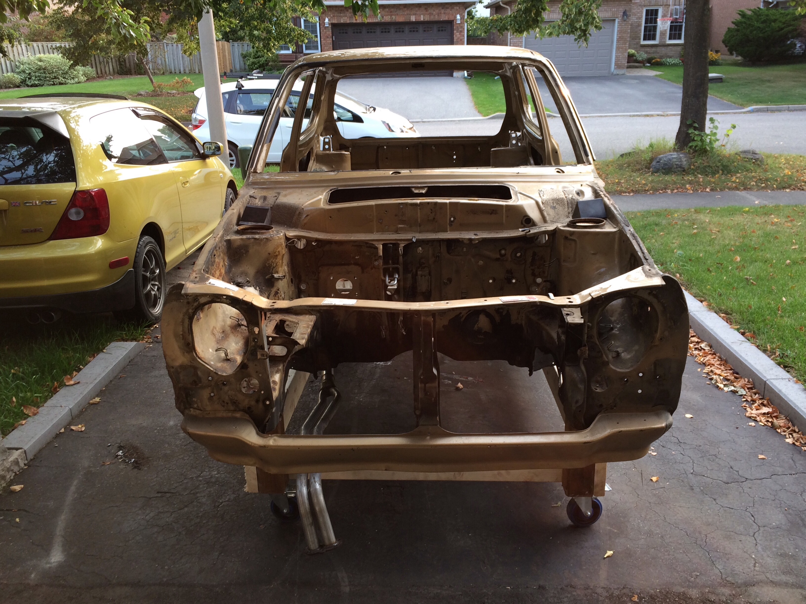

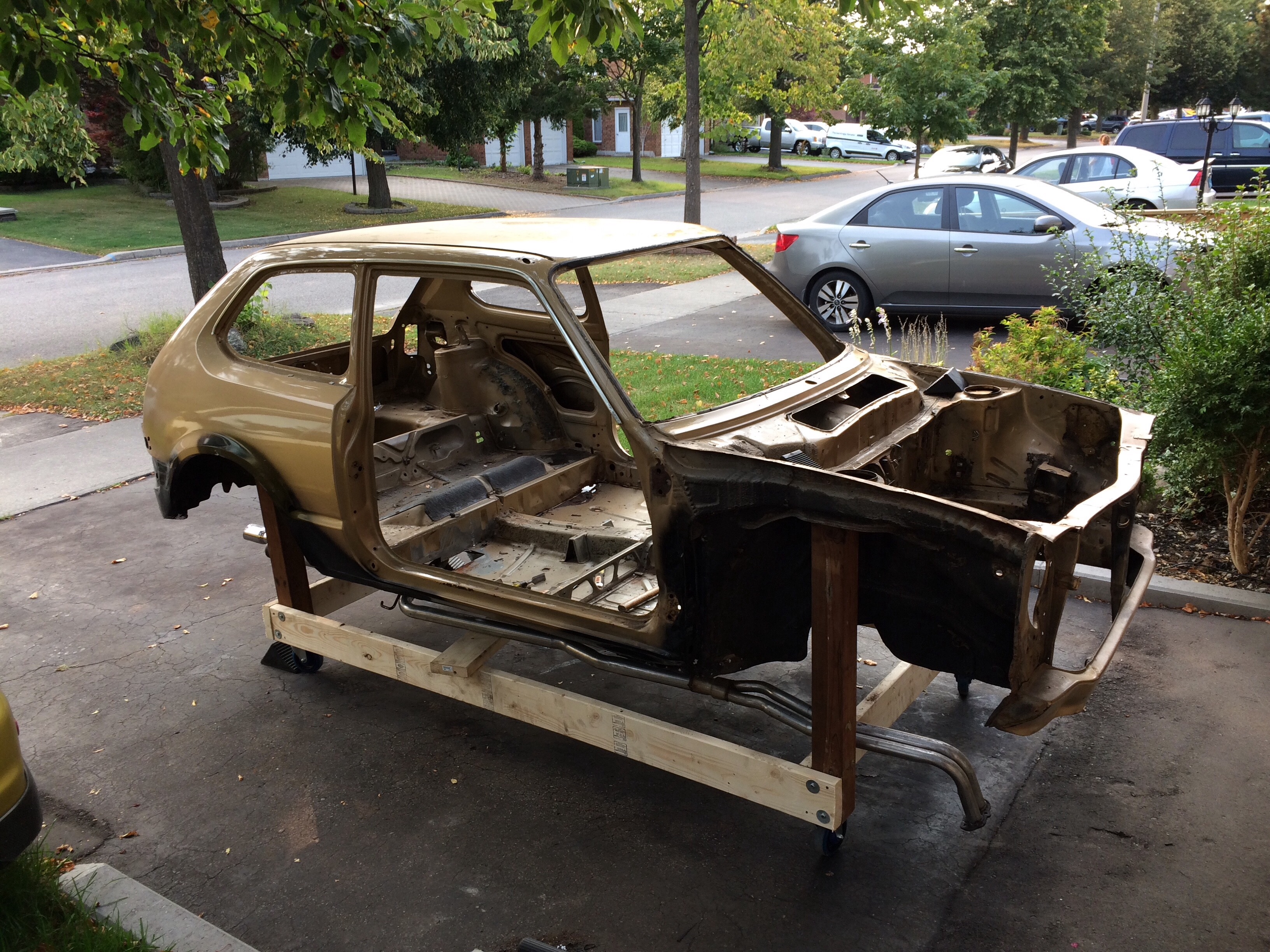

I put the car out on the driveway to put some good light on the new findings, holes and more holes.
:skull:
Looks Good, like a turkey ready for the oven :)

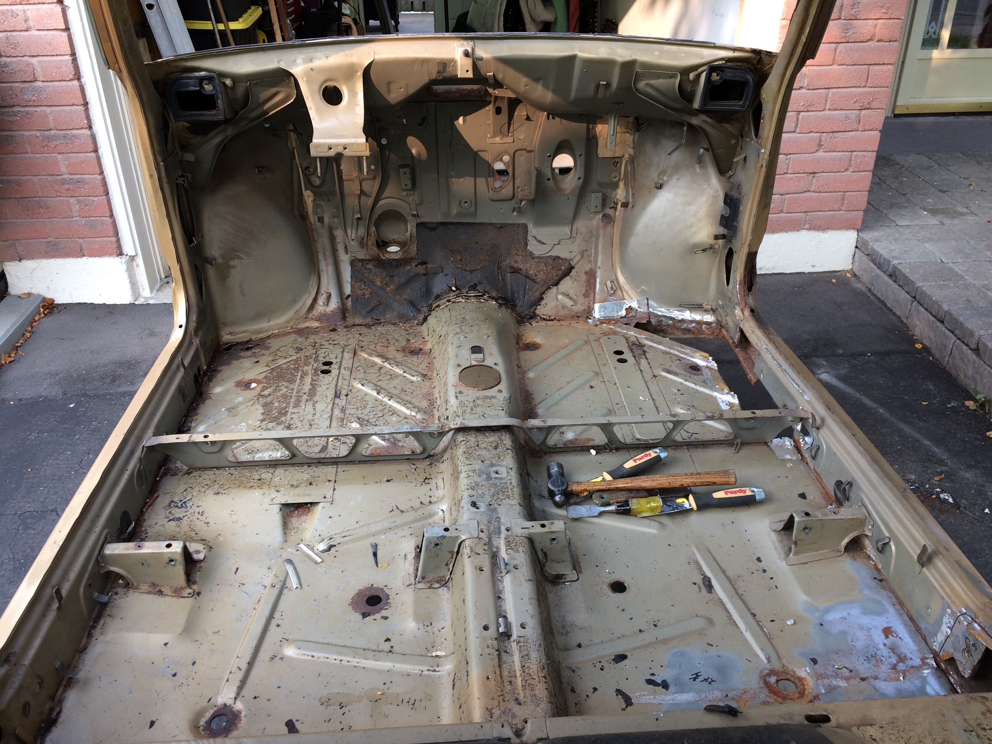

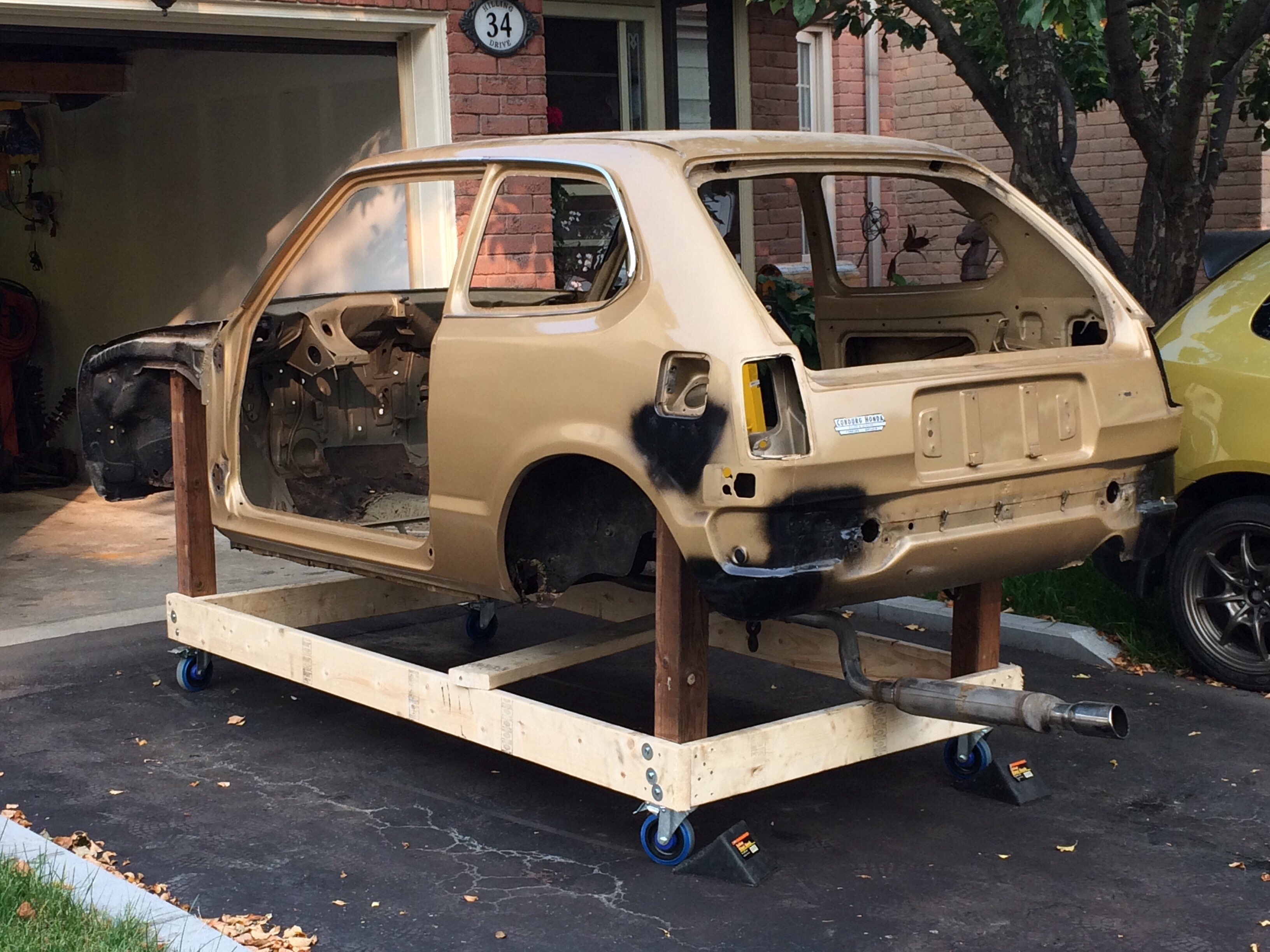

Rear view, black spots where I ground the filler off to inspect the quality of previous repairs. Not too bad.
Rear view
Rear view

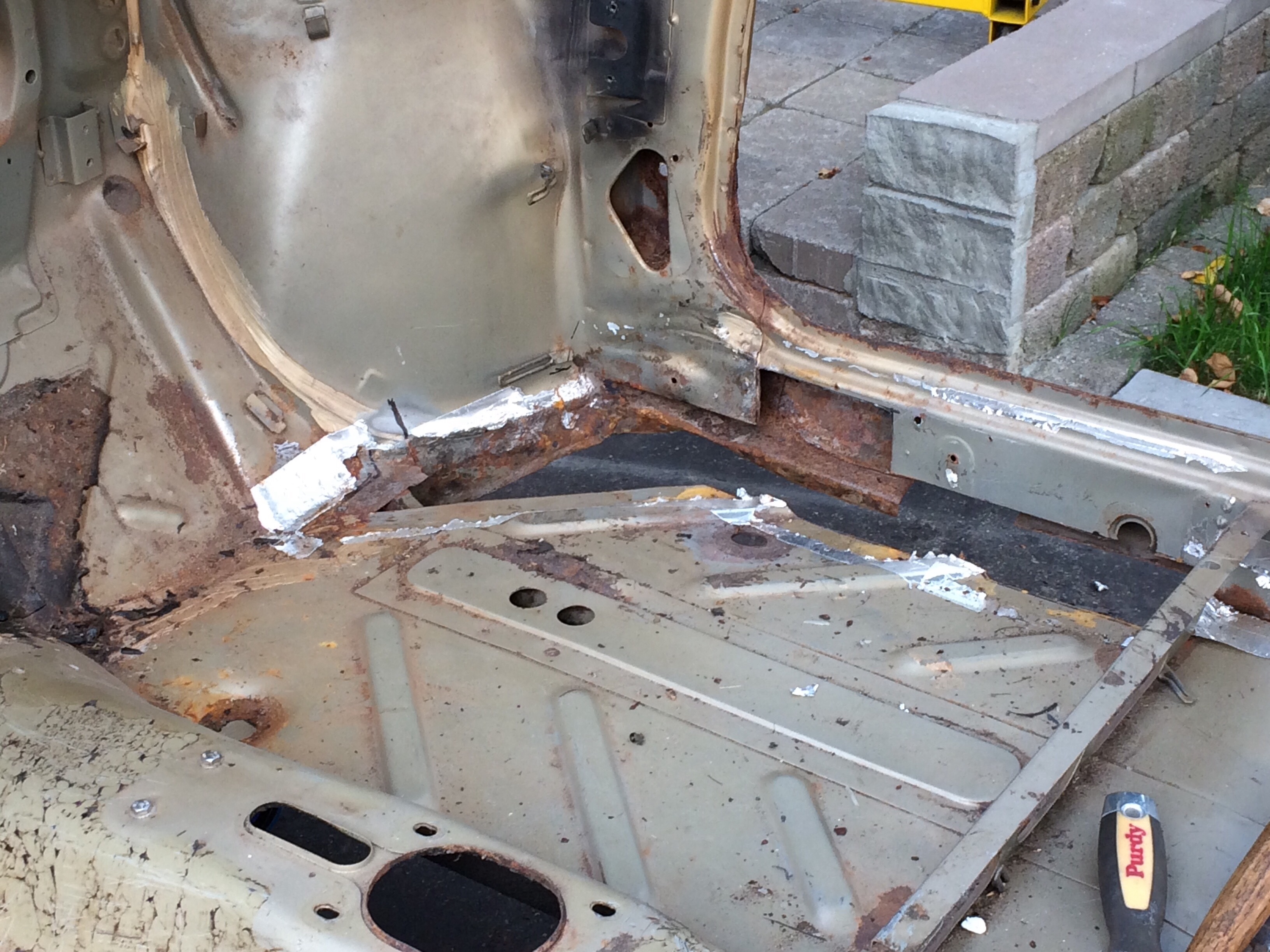

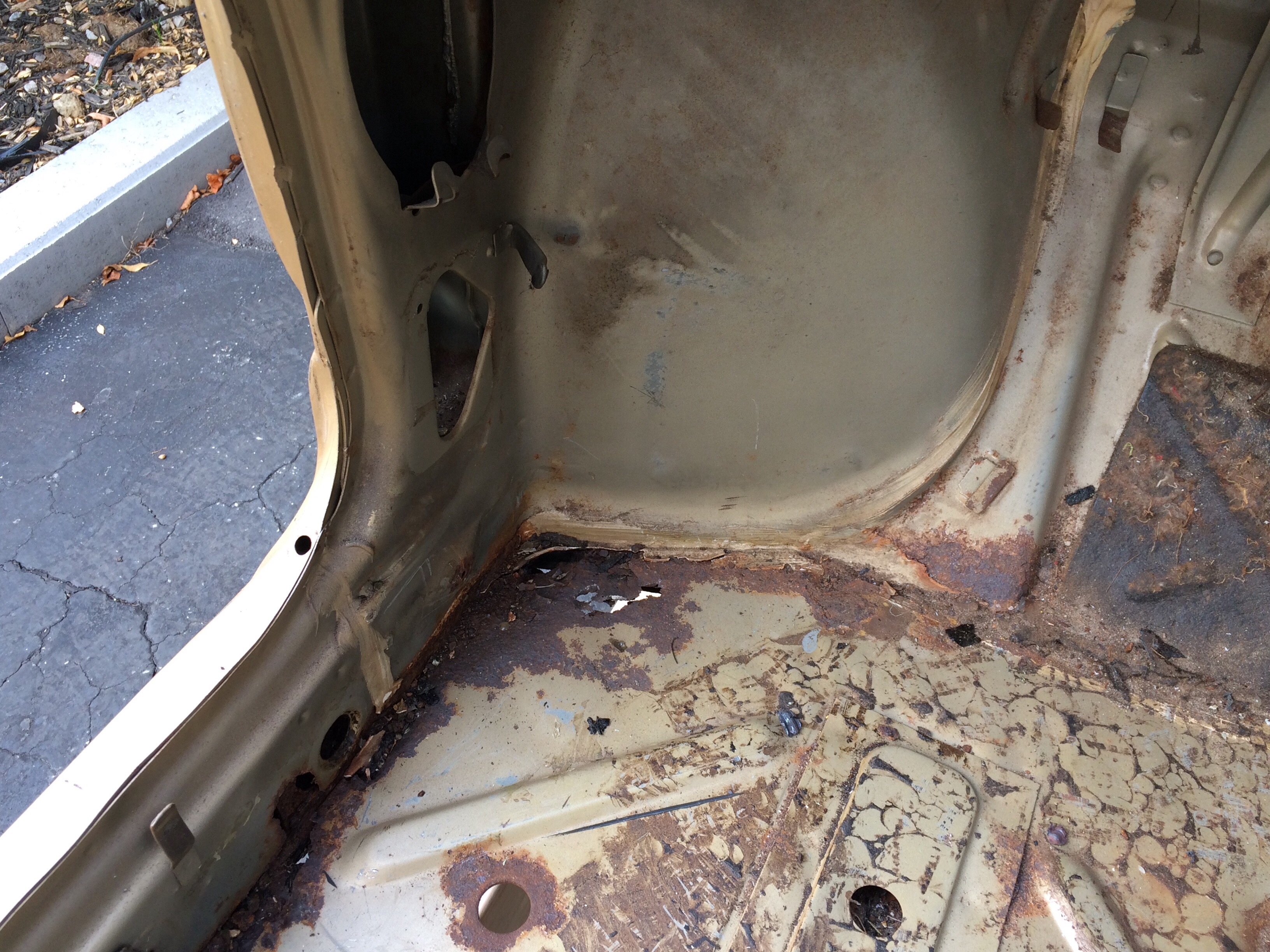

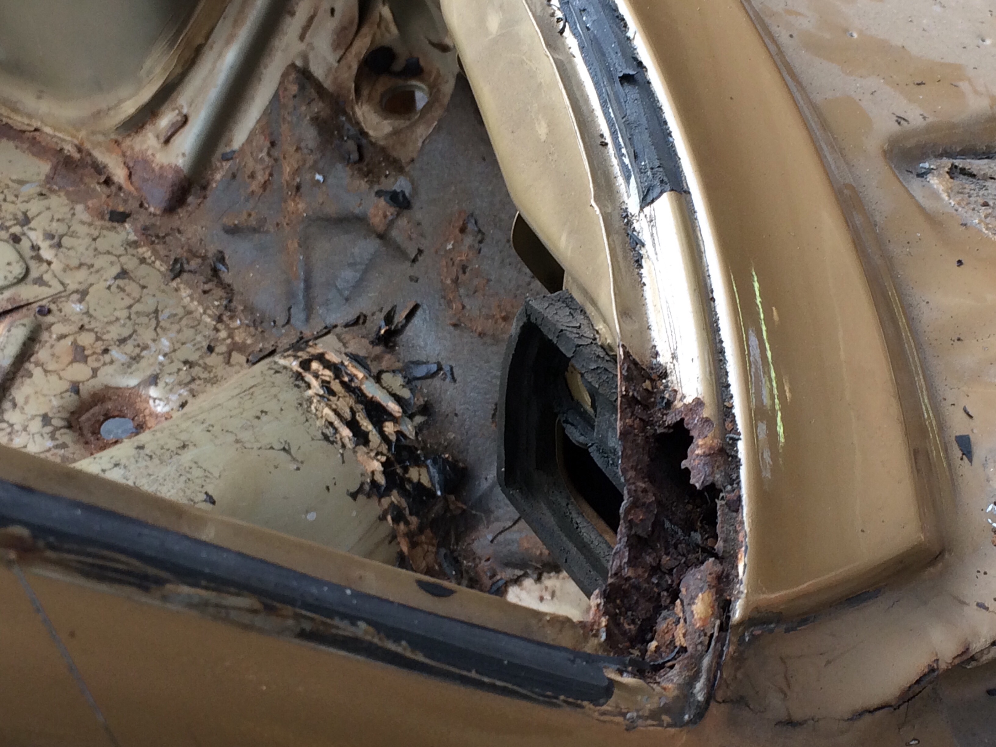

Rotten floor and rocker panel has to go.

I expect this side to be just as bad as the other.

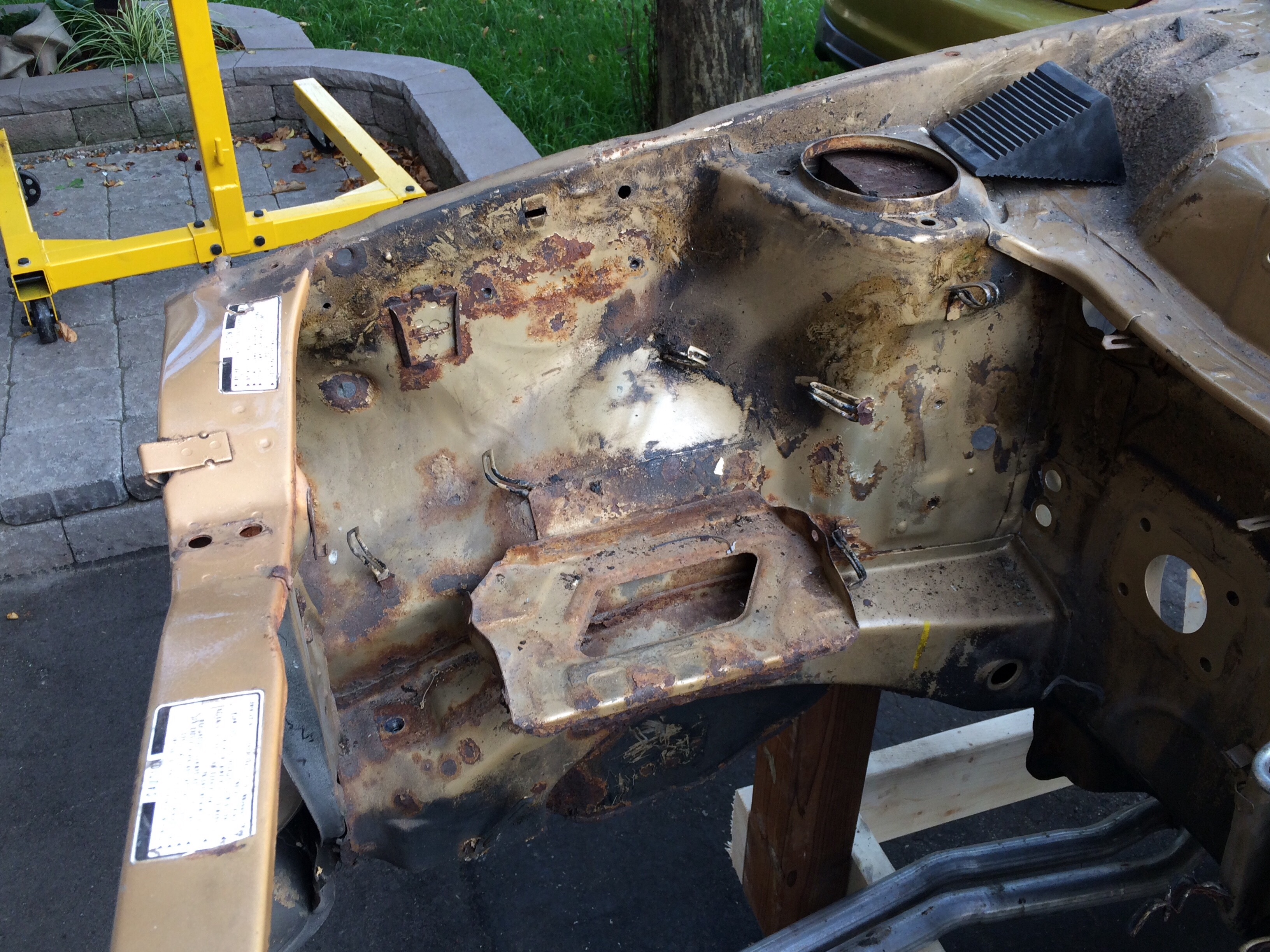

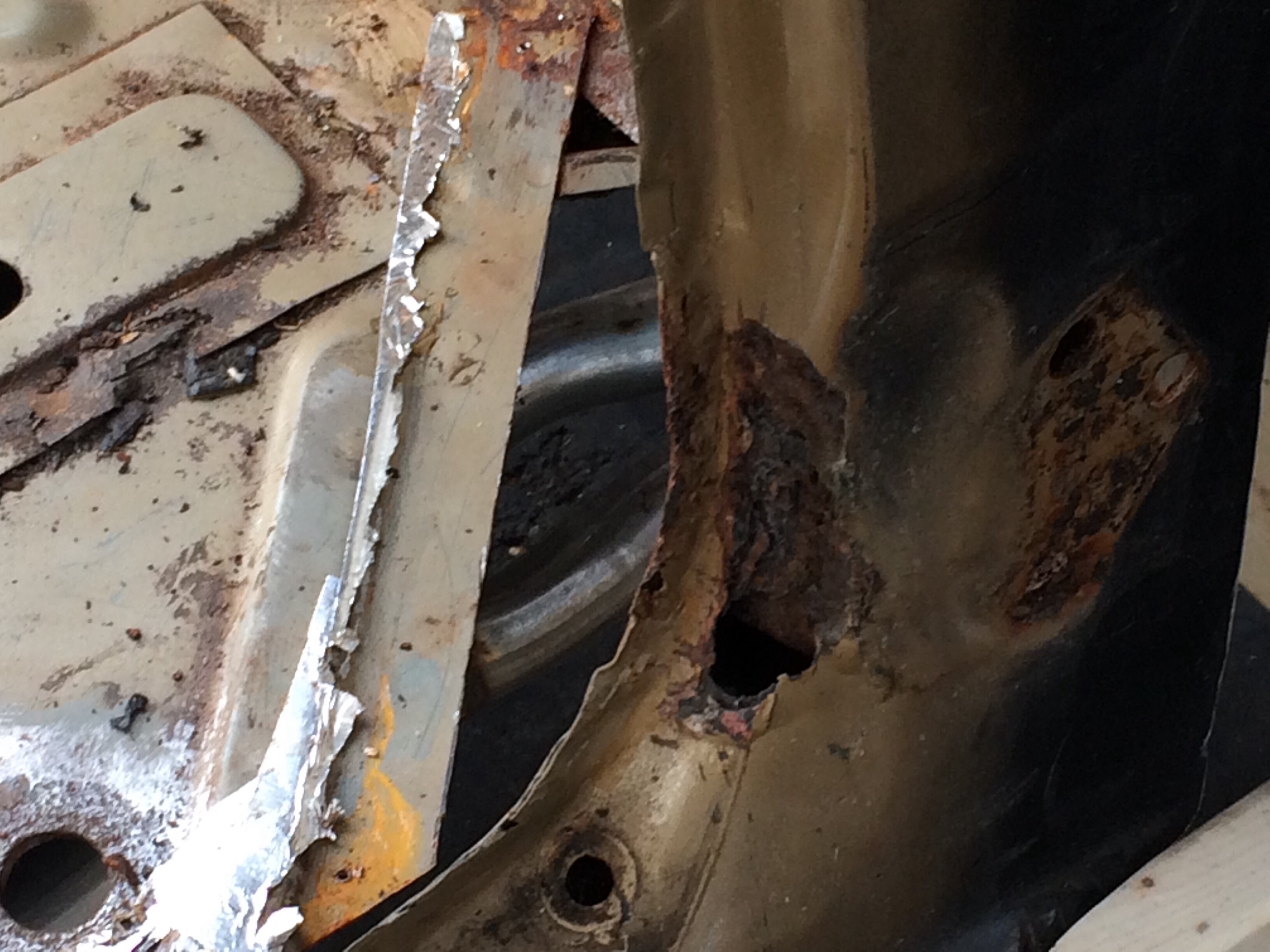

I did not expect this, rotten through to the inside and down the door pillar to the bottom.
I told you, to the bottom, this corner was also involved in a collision including the lower door pillar.

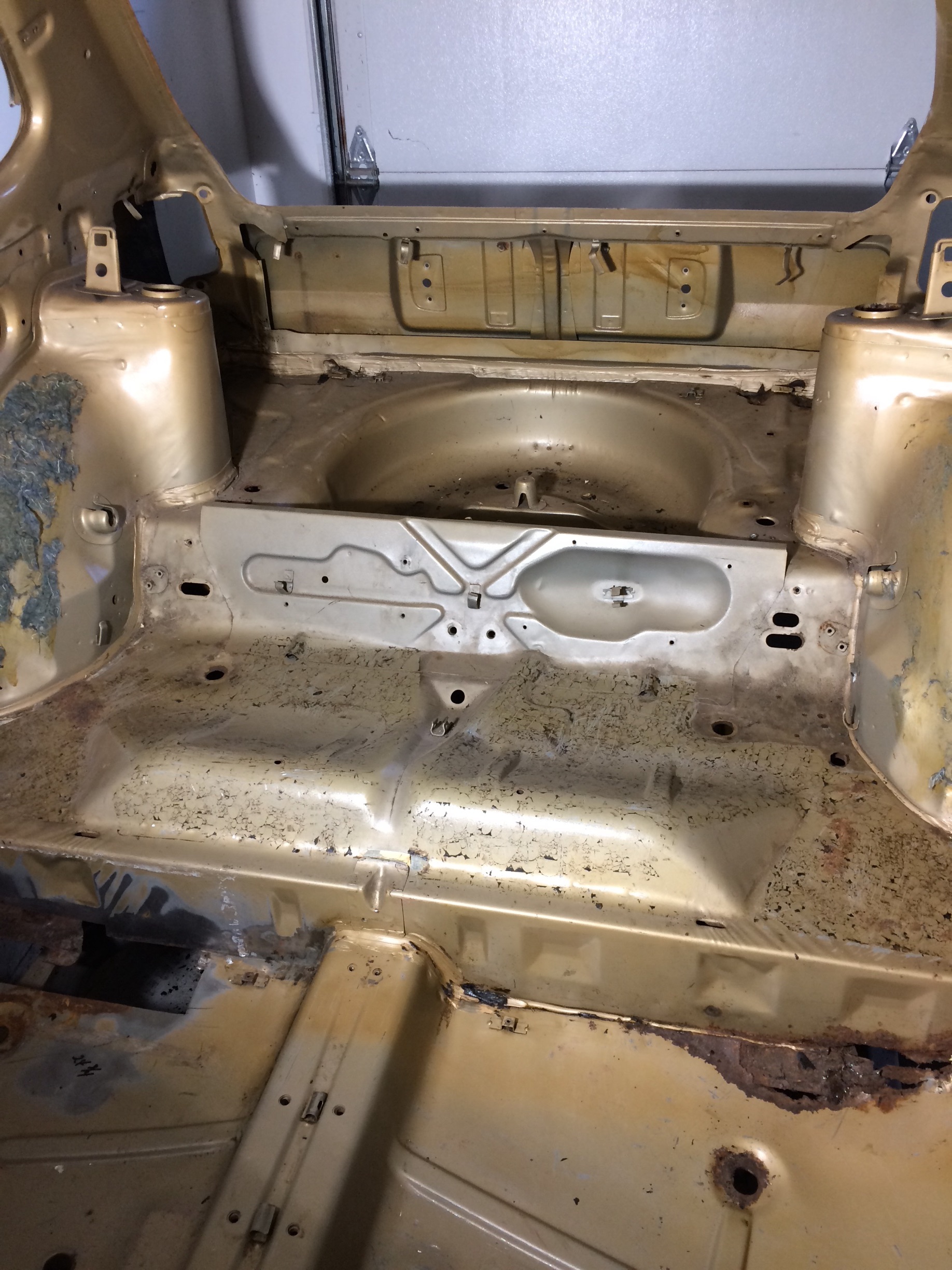

This area is not so bad, once I get the dirty old Waxol off and the bit of rust. Is the battery going to the back in the future?

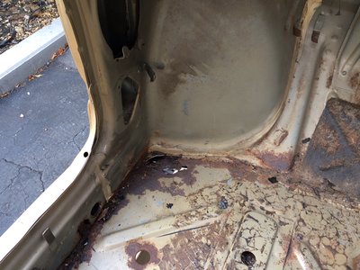

Door pillar is full of body filler and rotten at the bottom.

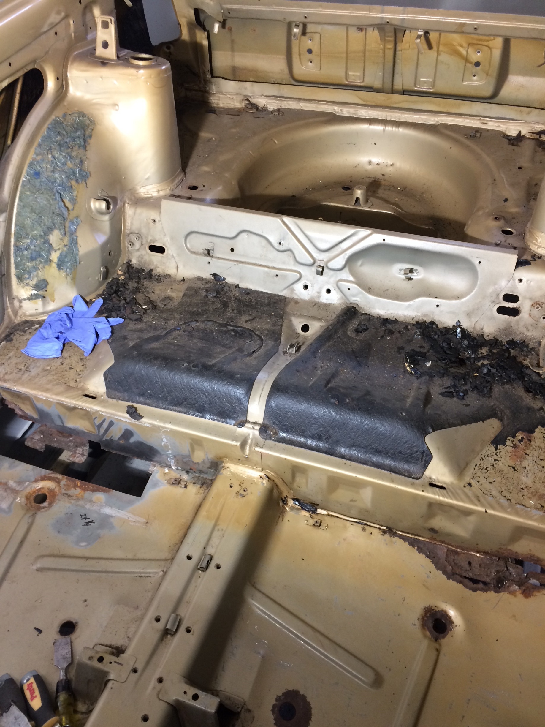

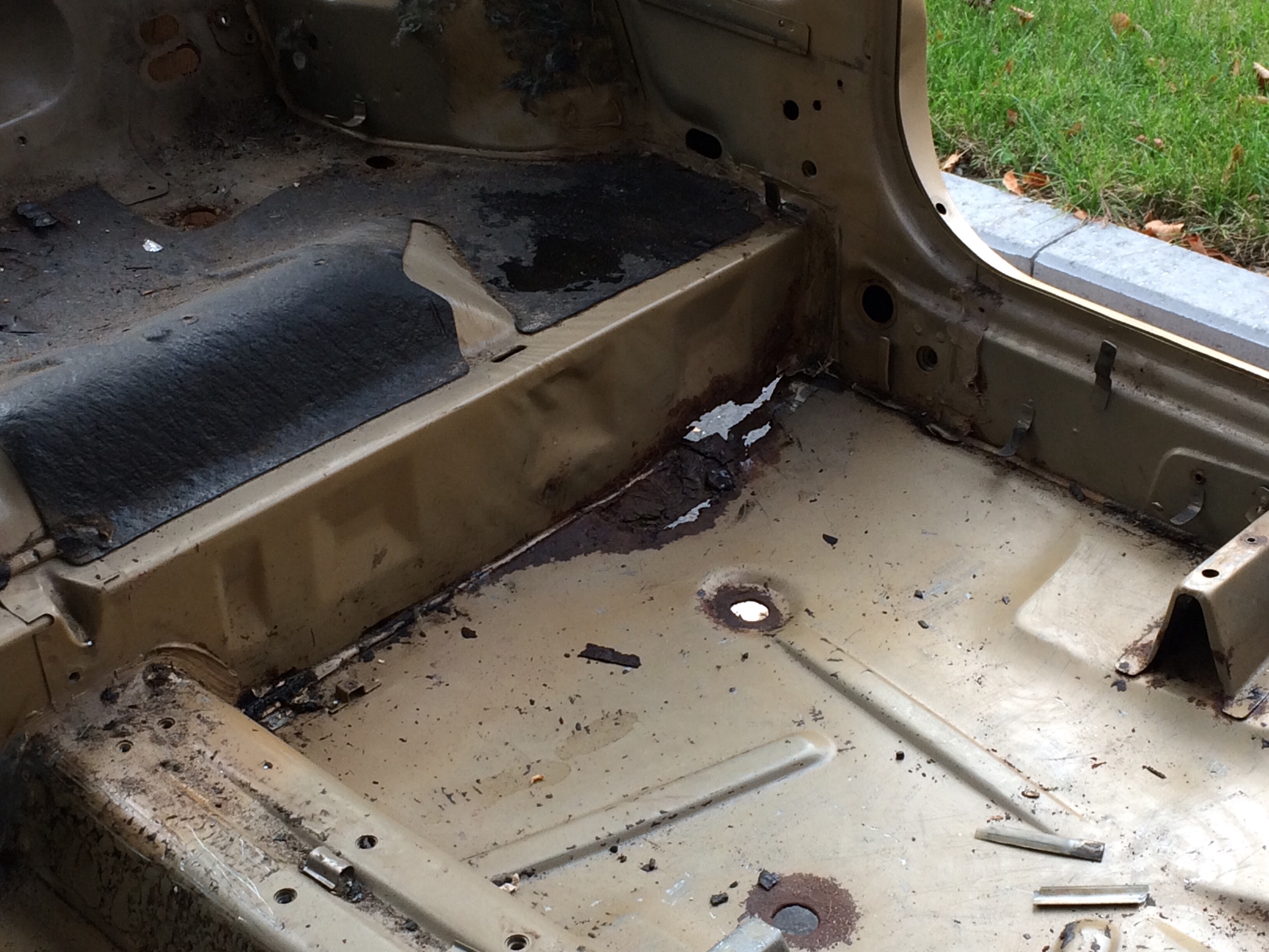

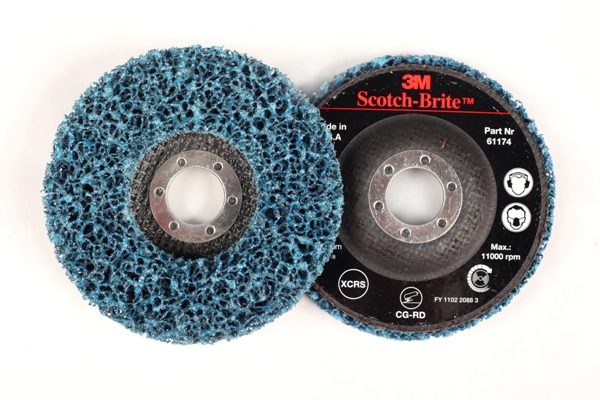

I made it out to the garage last night to scrape off the rest of the black tar coating under the back seat 💺 . It was pretty chilly that it came off easily with a stiff beveled putty knife and hammer 🔨
Plan is to try one of the 3m clean strip disks and a heat gun to take the seam sealer off. With a lot of scrapping and digging with a putty knife and screw driver.

Last night I cleaned up the rest of the black residue with some mineral spirits (var-sol) from the back seat.
I tried one of these disks on my mini grinder, and wow it ripped that stuff off like butter. It did a great job of removing surface rust too.
Around the back seat and along the floor the space is too tight to get the grinder in, so I used the heat gun and scrapped it off with a putty knife. It's not fast but it does save your hearing and keeps the dust down.
I cannot believe on YouTube the number of DIY'ers using a torch, that stuff is so toxic when burned and the risk of setting the under side of the car on fire is too risky. :204
Seam sealer makes a really nice cloud of dust when taken off with the disk.
