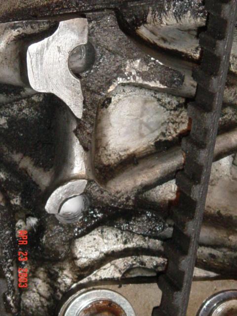

Since I took these pictures, I drove the car for only 2 days after certification (Sept 2002). This is when I found that the cast mount on the drivers side of the engine block was broken right off.
The camshaft key way and camshaft wheel is badly damaged. I can only assume that it came loose from vibration from the broken engine mount.
The timing belt was also chewed up. This is what it should look like on the far right.

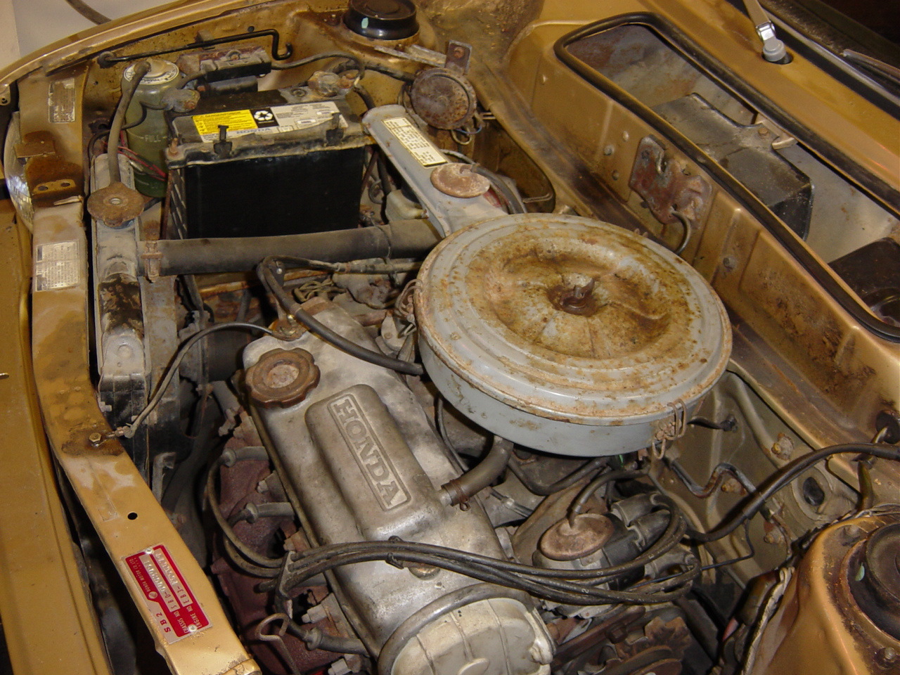

Checking a little further, this is not the original motor, it should be an EB3 but in fact has a EB2. Someone at Cobourg Honda must have done an engine swap with a defective mount. I checked over the car and could not find any damage to the body to verify it had been in a collision. This is usually how the mount breaks. It also had a rebuilt automatic transmission put in a some time. On further examination I noticed that one of the starter bolts was loose and the lower one was hanging out. When I removed the rocker cover all the front rocker screws were damaged as if it had been knocked over somewhere.
After some serious thought I wanted to keep the car original, I had an extra EB3 engine, I took it in to Scarborough Engines to have it rebuilt but could not source over sized pistons. Many years ago they were a major re-builder for Honda. I also have a 5 speed transmission w/chrome shifter from a Special-X to put in during the swap. The motor sat for three months at the shop at which time I ran into a chap that was racing these cars at Mossport dry raceway and on ice during the winter. He had 4 ice racers and one stock car. (2 ice racers were rabbits)

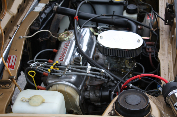

Engine Swap
Below in the video my son is hiding in the garage while I talk with the previous owner of the motor to figure out why it runs so rough.
Well I didn’t get my EB3 rebuilt, for a lack of finding over sized pistons, instead I bought a newly rebuilt motor that came out of Jeff Wenzel’s Ice Racer, previously rolled. It’s only run about 50km since the motor was rebuilt and all I had to change is the oil pan as it had a tiny rust hole. The bottom and top end of the motor is spotless. It is an EB3 Motor with and EN1 head from a second generation Civic.

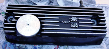

The Mugen valve cover will fit any of the first generation Honda Civic heads being of the EB1, EB2 or EB3 types including the second generation Honda Civic EN1 types too. This will not fit the CVCC Engines.
Here Colin Kennedy is helping me trying to set up the timing and the Weber carburetor. In the end the timing had to remain advanced by about 28 degrees plus. I found out later from the guy I bought it from that it has a racing camshaft shaft and he kept it at about 35. He said it is going to be difficult to take this motor and put it back to street use with out too many problems. One thing for sure is the exhaust is too small as I am using stock, I noticed that starting is difficult but for some reason when I had the muffler off it started first shot. I have taken the Weber off the car and put the stock carburetor back on and this seems to have helped a bit.
Turns out after a little research that the 28DCD Weber carburetor is used in the UK or European countries on the Ford Cortina. No wonder I had problems with it. The adapter is a standard Weber intake manifold adapter for the Cortina, however it has been welded to the Civic one since the bolt holes do not line up correctly.

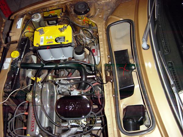

I have prepared to pull the motor, Removed the grille and hood as well as disconnecting the shifter linkage and carburetor choke and accelerator cables.

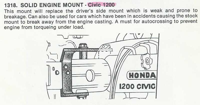

This is my EN1 head W/broken off mount | EB3 head for 78-79, note the differences EB3 heads have an “H” stamped on the front passenger side while the EB2 has a “S” in the same place. As for the broken mount I will be using a modified transmission bracket from an second generation civic for the torque rod to attach to.
I fabricated a bracket for the torque rod to fasten to, picture on the right was my second shot after breaking the first one a couple of times, It kept on breaking the bracket that bolts on through one of the starter bolts and one of the transmission bolts. I had to double up the thickness of the Honda bracket to take the torque. I then attached the old outer torque rod bracket and attached a rod from it to the manifold which seems to be holding quite well so far.
The bracket would still bend away from the head causing the muffler to break off as well as bending the strap that holds the downward exhaust pipe. This is also my second muffler, The first one broke off right at the muffler.
Here is my new design, you can see I used a stock bracket and flipped it with a 3/8″ rod with a bracket on the manifold. This method is really strong.
Here is my first attempt at making the bracket work. Bummer total failure, the torque from the motor causes the A bracket to bend away from the head causing the mount to break the metal tab used to attach to the starter motor bolt. I welded it back up, this time the tab is about 1/4″ thick and the other leg of the “A” has to be beefed up as well as it broke the leg off.
I bought this oil filler cap on the internet on line auction. I am not sure if its a Honda
Original or just and aftermarket creation. Its a little rare, but I don’t think there is much value other than its just different. I ended up buying new original OEM old filler cap that looks a lot nicer because of the shine I guess.
As you can see I have not used the Mugen cover. I purchased this nice polished cover instead because I am looking for a different look. I just need to get rid of that dirty breather.
Before and after shots

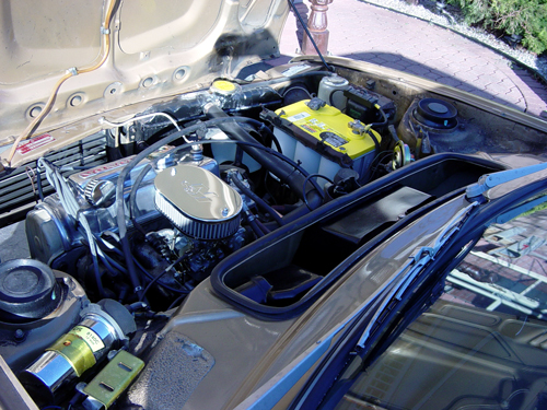

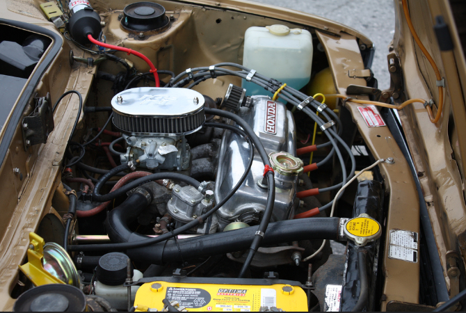

Downdraft Carburetor
Weber 32/36 DGV down draft series of 2 barrel carburetors are available with various throttle bore sizes, and manual or automatic chokes. These will give that quick throttle response you are looking for, they also have larger barrels and venturi than the stock Honda carburetor that allows the engine to produce greater power at a higher RPM. Weber kits can be found at carburetor Unlimited
Weber 32/36DGV (Manual Choke)
Weber 32/36DGEV (Electric Choke)
Here was a deal, $165.00 us for a Weber 32/36DGV manual choke carburetor. I only wish I had bought one more at that price.
This kit is easily put on and includes all the parts needed to get you up and running in no time
It also includes the bracket that goes on the intake to hold the throttle cable. This is a good carburetor for the every day enthusiast looking for more power and performance. This is not the best one to use if planning some serious driving as this Weber has problems in the corners at high speed.
One modification I have to do is to remove the area of the intake that the adapter covers, I just have to remove the material in the opening of the adapter. This will also give me better performance as well. This was a good time to replace all the old vacuum lines.
To install the accelerator cable is possibly the only difficult thing about installing a DGV Weber on your old civic.
First get a piece of metal about 1 inch wide by 4 inches long and about 4-5 mm thick. drill a hole in either end about 8mm or so (I am not sure about this).
Then make 2 bends, one about a centimeter above the bottom hole of your choice, and to the right at about a 45 degree angle. then one more about a centimeter below the top hole, so that when the bottom is attached underneath the nearest intake manifold bolt, the top hole is totally facing towards the linkage area. this may need a little adjusting. you may also want to cut a slit a few centimeters wide from the top into the top hole. makes it easier to get the cable in. The accelerator cable can now be screwed into the hole at the top. there you go. Weber throttle cable bracket for the 1200.

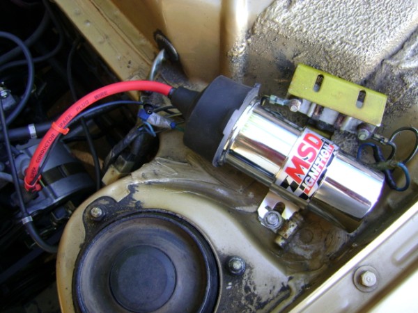

Ignition Coil
Use of the Pertronics or MSD Blaster Coil to boost voltage and gives a better spark. It improves to 40,000 volts, the higher voltage allows larger spark plug gaps for added power, smoother response and better fuel economy. Delivers an average of 15% more spark energy and voltage. It's just a regular 1.5 ohm coil with built-in ballast resistor to a total of 3 ohms, or stick with the stock 1.5 ohms coil and keep the ballast resistor.

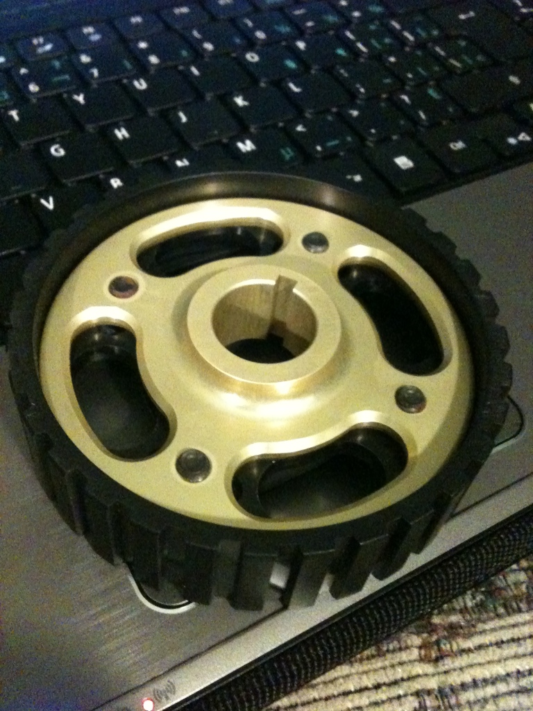

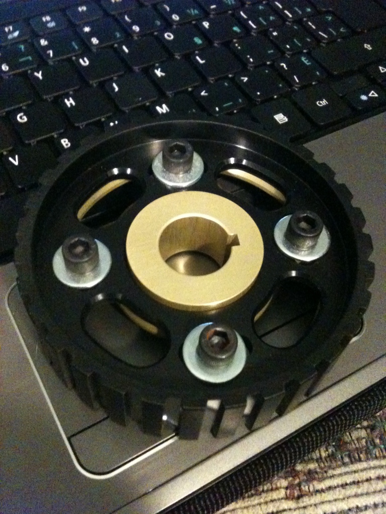

Adjustable camshaft Gears
The whole point of adjustable camshaft gears is to allow the user to put the camshafts into the optimum timing position. But what is optimum for your car? The answer is, it depends. Engine size, camshaft profile, performance modifications, any of these will affect the optimum position for your camshafts. If you pull your cylinder head and have it milled, you'll surely be interested in adjusting your camshaft timing back when you find out you're a few degrees off without having touched anything else.
Even if your car is absolutely bone stock, right down to the floor mats, you can still benefit from the use of adjustable camshaft gears. Adjustable camshaft gears allow you to tweak the conservative factory settings for increased power and drive-ability. Adjustable camshaft gears also give the user the ability to shift peak power throughout the rpm range, a big plus if you are a low-end city driver, mid-range auto crosser, or high-rpm drag racer.

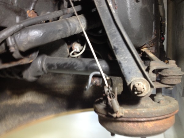

Turns out that, (Colin) The lower control and trailing arms + the shocks and rear brakes in your car are from a 78 CVCC hatchback that the dealership acquired for parts in 1998. The shock spring mounts were rusted bad on the original shocks, so we just changed everything on both sides. To be honest, I never noticed the difference when I changed them, but it is pretty apparent now.

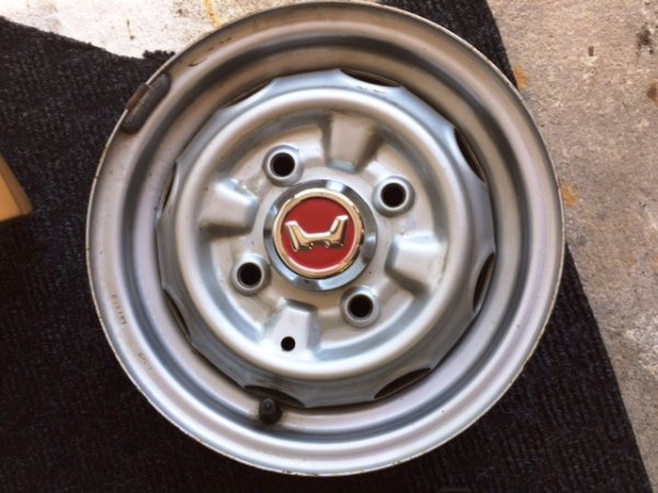

Wheel Restoration
I am hoping that these worn out old Cheviot 13″ wheels can be brought back from this horrid state of condition. Many years of racing have left scars on the aluminum wheels. Most of the fake screws are missing from the outer diameter of the wheels.
Finally got around to refurbishing these old beat up Cheviot 13×5.5″ wheels, This size can be found on the Accords if you are looking for some in the 4×120 bolt pattern.
I started of by using a coarse flat file to take the gouges out, followed up by the use of a Drumel tool to get at hard to reach places in between the webbed patterns. The use of many grades of water paper can make this job go a lot quicker and less work. I started off with 40grit 60,80,120,240,400,600 and finished of with 1200grit. A final chrome like finished was obtained by using Mother’s Aluminum Polish.
To get the Honda Civic Stock wheel caps to fit the Cheviot wheels I filed off the ridge from the opening, Minor bending of the cap tabs was also done. To help the cap maintain a tight fit I drilled 1/8″ divots inside the opening for the dimples on the caps to sit snugly in.
Before the final finish can be applied the outer polished areas are taped up with Duct Tape. This is done to protect the finish from the sand blasting that will remove the old paint and even out the rough areas that were repaired.
To sandblast I created a small area in the garage with blue tarps with weights on the bottom. or you can use plastic shower curtains from the dollar store that have weights built in already. After the sand blasting I cleaned the wheels with mild soap and a pressure washer to clean them up. I left the duct tape in place while cleaning.
I went down to the local Napa auto parts store to get my cars colour mixed and put in two pre-charged cans for easy application. I also bought clear coat for wheels, but the type I used must be applied while the base coat is slightly tacky. I removed the Duct Tape after the base coat (colored) was applied. The area where the tape was cleaned with paint and silicone remover. I put several coats of clear coat on the entire face of the wheels. When the clear coat goes on its a milky colour, Don’t panic now, it clears up as it dries.

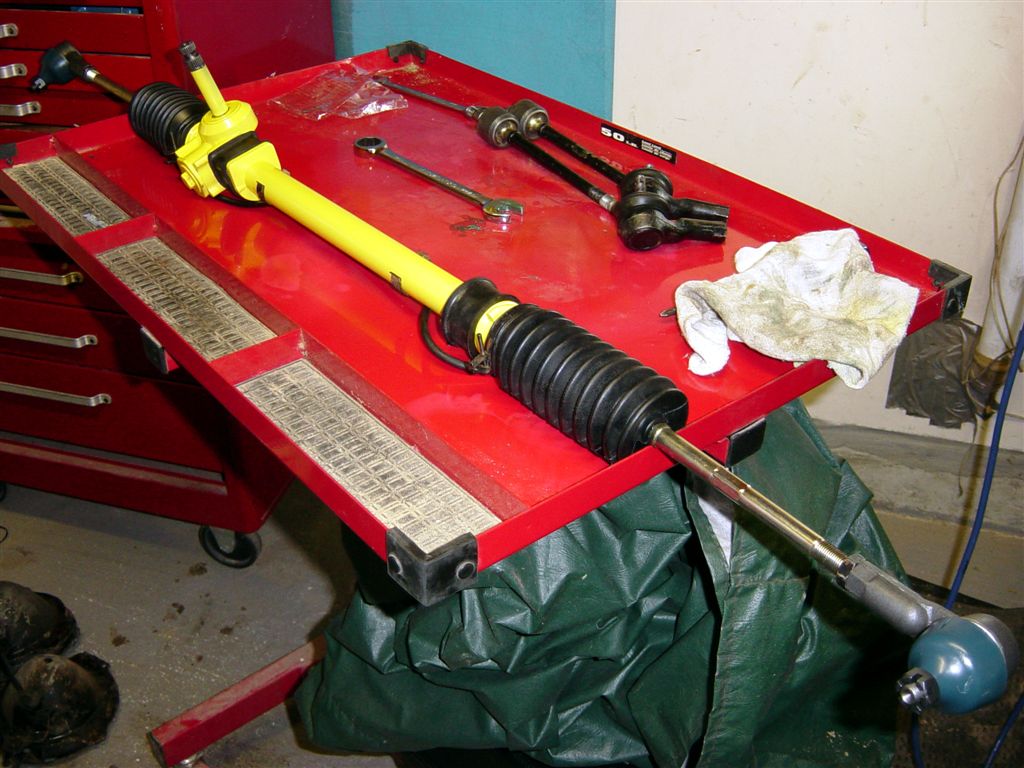

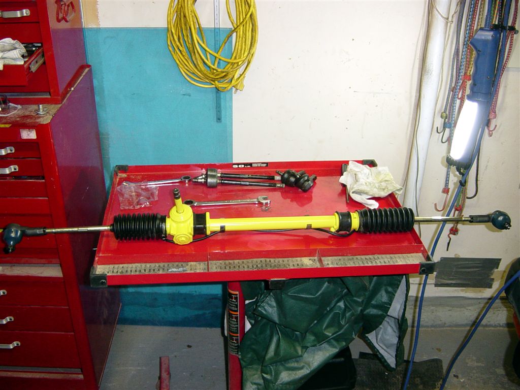

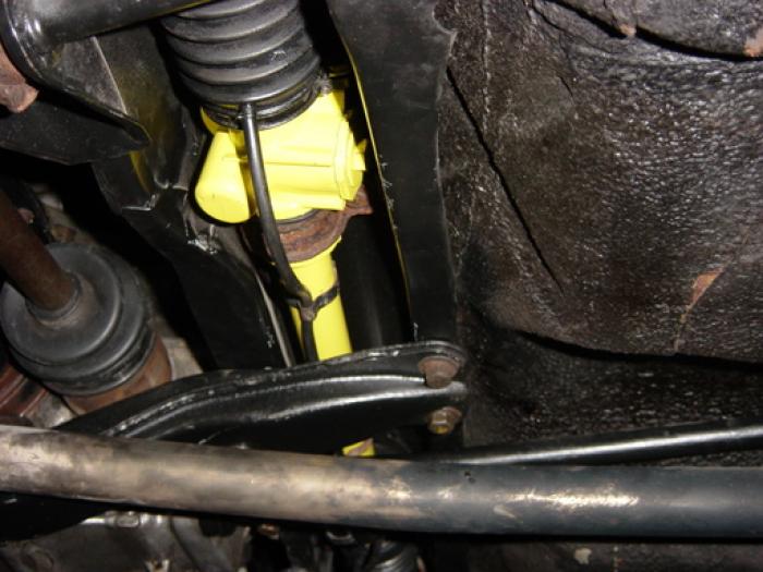

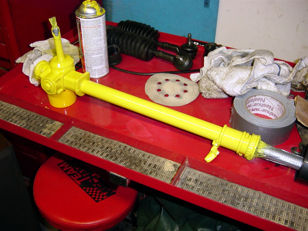

Steering Rack Rebuild
While you have the unit apart it you could adjust the play in the gear by releasing the large lock nut on the bottom and adjusting the bolt. You can feel the play as you turn the shaft. Don't make it tight, and it make take a while to get it just right. Remember to tighten the lock nut when finished making you adjustment and retest to make sure the gear and still be turned by hand.
During assembly of the tie rod ends I measured and put them on in the same spot as the old ones.
Now get it back in with out scratching the paint.
Remember to get you alignment done after this procedure. To get it straight I used a measuring tape with the steering wheel still straight with the bungee attached, I measured the front edge of the tires from center to center. Then measure the same on the backside. I left the front side of the tires a bit narrower than the backside.
As it turned out when I took it in for alignment it was perfect. The garage only charged me for setting it up.
To see more of my steering rack rebuild Diy you can see it here:

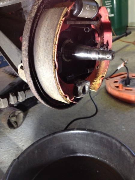

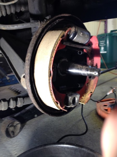

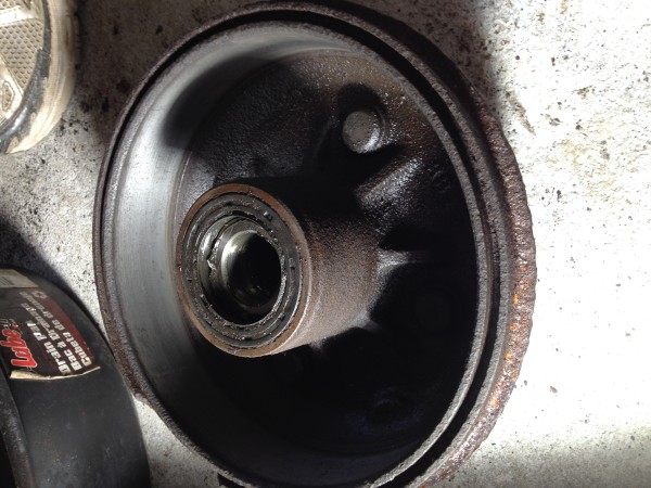

I had a problem with the brakes last fall after taking the car for a short ride before putting it away for winter storage. It was a short drive about 10km around the block.
The front right caliper seized up making it very difficult to shift gears. I had to drive back home in 3rd gear with the motor racing at a very hi RPM to keep the car moving. You can see by the picture of the wheel that the rim had turned red hot and discolored the rim.
It has been about five years ago since I bled the system and changed out the brake pads so I am hoping it won't be too serious as parts are getting very difficult to find locally.
Remove the brake fluid reservoir cap to allow free movement of the brake fluid and clamp the rubber brake line to prevent leakage when removing the metal line from the caliper.
I removed the brake pads to allow some free movement by jiggling with a pry bar in between the brake pad back plate and the guard to loosen it up a bit.
Then I pressed the brake pedal to see if I could push the Pistons out, they are free. Next remove the caliper from the mount and take off the brake lines. Don't forget to carefully clamp off the rubber brake line to prevent your system from completely draining
Apply compressed air to push the pistons out of the caliper, use caution where this is done as the pistons may come flying out fast. You may be able to re-use the rubber piston seals and metal retaining rings if they are not damaged. If only one piston comes out then you will have access to push the other one out from the other side with some force externally. Like with a small piece of soft wood and mallet.
Clean out the cylinder well, I used a Scotch Brite pad with brake fluid to clean it up. In the end I used a cylinder hone to resurface the walls true and clean.
Reassemble and test movement manually before the final assembly. Replace any worn out seals and badly rusted parts or replace the entire caliper if it is beyond re-use. If I cannot find new calipers soon I may just buy new seals for the pistons until I can source them.

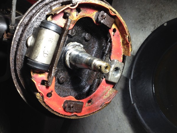

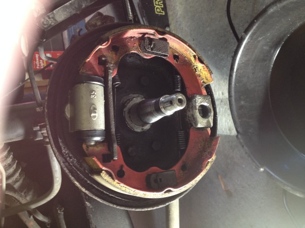

Rear Brake Drum Parts
Hardware Kit
42610-634-010 007 002 DRUM, RR. BRAKE
91252-634-005 014 002 OIL SEAL, RR. WHEEL BEARING
91052-634-008 012 002 BEARING A, RR. WHEEL (Outer Drum)
91053-634-008 013 002 BEARING B, RR. WHEEL (Inner Drum)
42327-634-000 005 002 SEAL, BEARING CAP
43300-680-931 007 002 CYLINDER ASSY., RR. WHEEL
46370-634-620 010 001 PIPE G, R. BRAKE
46371-634-620 011 001 PIPE G, L. BRAKE
43110-634-013 002 001 PLATE, R. RR. BACKING
43120-634-013 003 001 PLATE, L. RR. BACKING

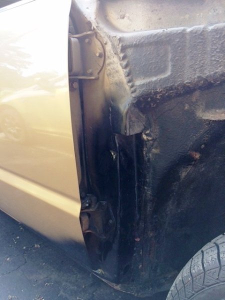

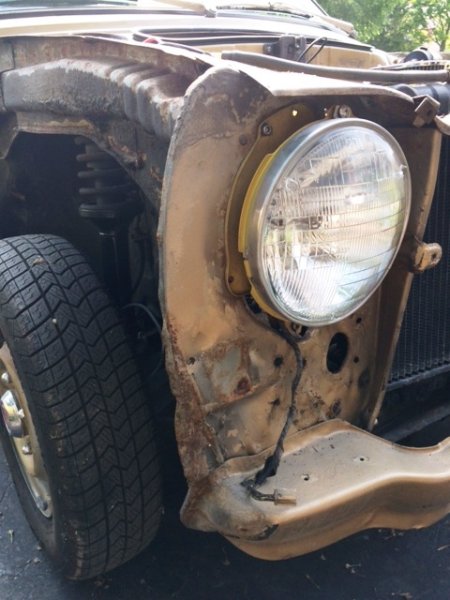

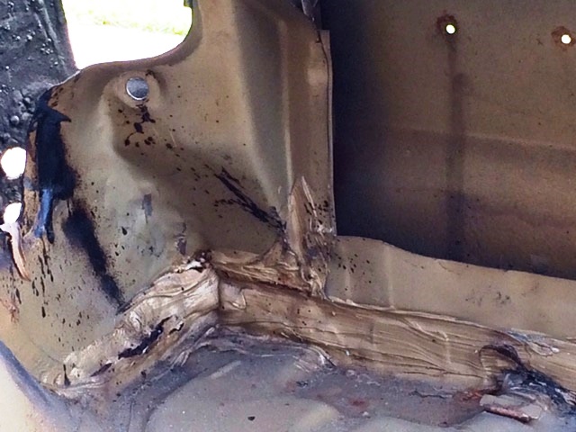

Fender Repair
In the spring of 2016 while backing out of the garage I did not notice the handle of the sheet metal brake was inside the fender. I did not notice until it was too late while looking over my shoulder to clear the side of the garage door as the car was very tight to the garage wall. I dragged the sheet metal brake part way out from the corner of the garage very quietly due to it being on wheels for ease of movement.
Keep in mind, though, that overworking the metal can cause it to become brittle; then it might begin to crack rather than bend.

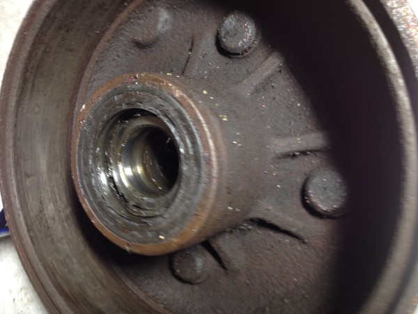

1978 Honda Civic Seized Drum Brake
Post by Randy »
Wheel Bearing Grease Leak

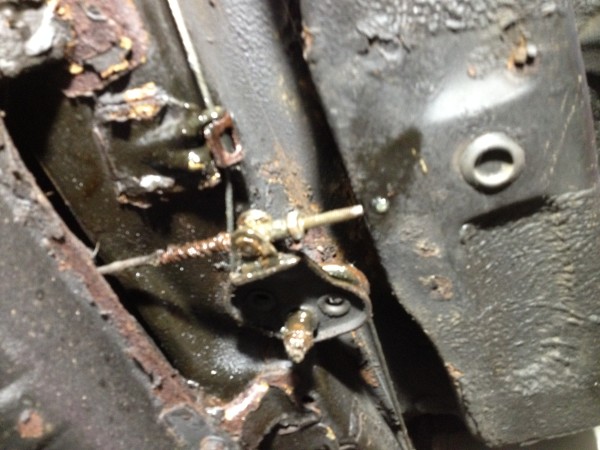

Seems to have been more than one seized up brake. I jacked up the back end of the car to free spin the back wheels to find out which side is causing the problem. It's the left driver side that is stuck solid, that's why the wheel has been dragging when I try to move the car onto the driveway.
It's pretty cold today so I fired up the propane heater for about 10 minutes to take the chill out of the air so I could peel off one of the extra layers I had put on to keep warm.
ImageWith this new handy Led light there will be no more cooking from the heat off the old Halogen light.
I lowered the car back down onto a pair of these wheel dollies, they are great for moving the car around the garage allowing me to create a bigger work area any time I want. I hope to get anther set for the front wheels in the future to make the car more mobile in the garage.
I would begin by releasing parking brake inside the car and also releasing the tension the cable to the rear drum, this would allow more wiggle room to free the drum from the seized brake. At this point I have no idea the shoes were swollen with oily grease
The grease is not so bad in the sense it is slowing down the rust, Nasty

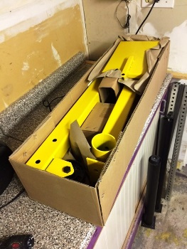

2 Ton Triple-Lift Multi-Purpose Floor Jack
Lifts automobiles, ATVs and motorcycles
This extra stable jack will come in handy, plus with the rubber padding will protect the jack from cuts and scrapes from lifting a rust car. Or is it the other way around!
Comes with a lock bar for safety and also has rubber wheel locks.

While working on my car a chap came by my house that saw my car in the garage earlier and offered to sell me some original wheels and caps. Never used as they put allows on the car after they purchased the car.
Turn out he used to work for Honda Canada. Funny bit is he has an N360 that I spotted while out on a run.
I hope to get the other three rims soon.

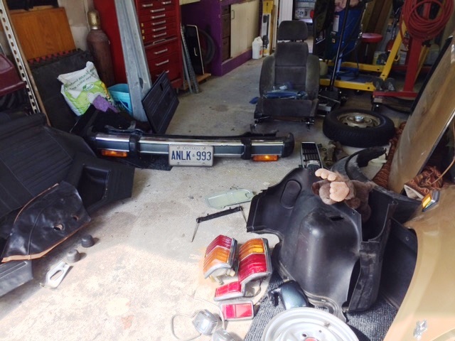

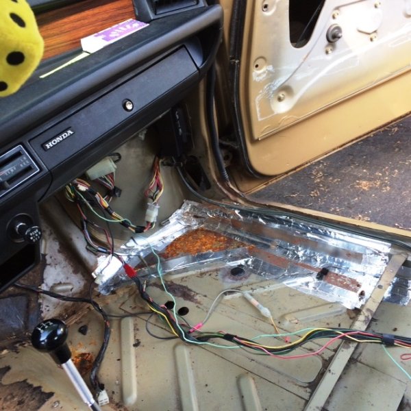

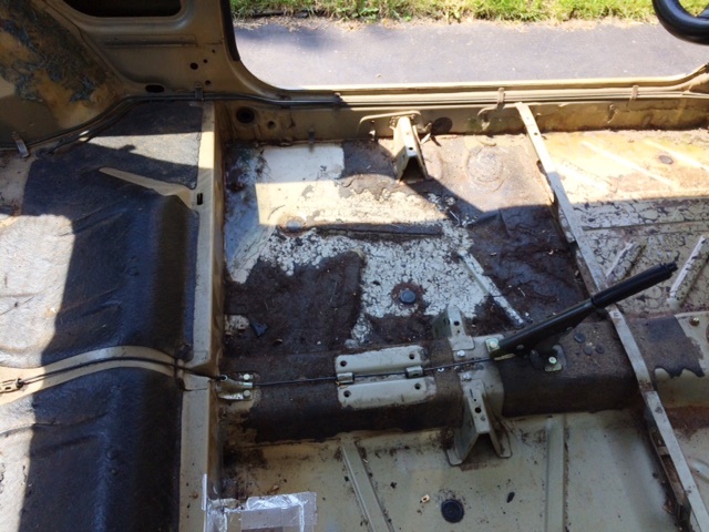

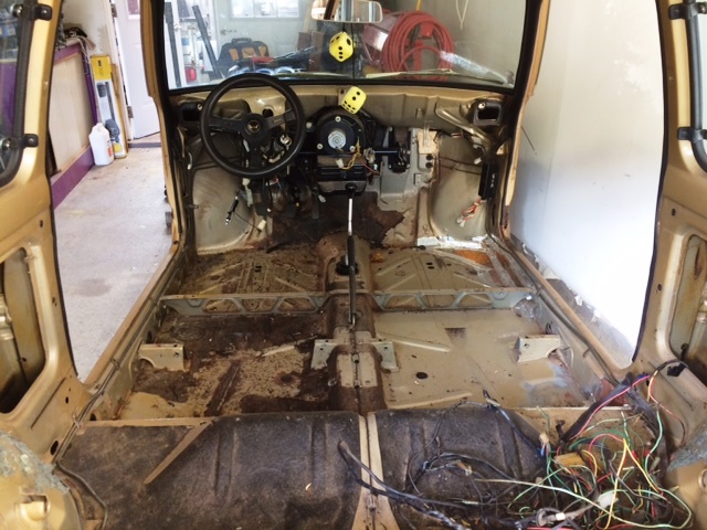

Here is what has been done since I bought the car in 2000.
Modifications:
Upgraded to 5speed manual transmission from special x model. Modified motor w/ ported EN1 second generation Civic head, lightened flywheel, shaved pulley, racing camshaft. Weber carburator kit and Honda RS cast 4-2 exhaust header. 2" custom exhaust. CVCC rear suspension.
Special X guages and short shifter modification, and 91 Prelude seats, oem overhead… and rides on Falcon Zex mounted on 13" Accord alloys.

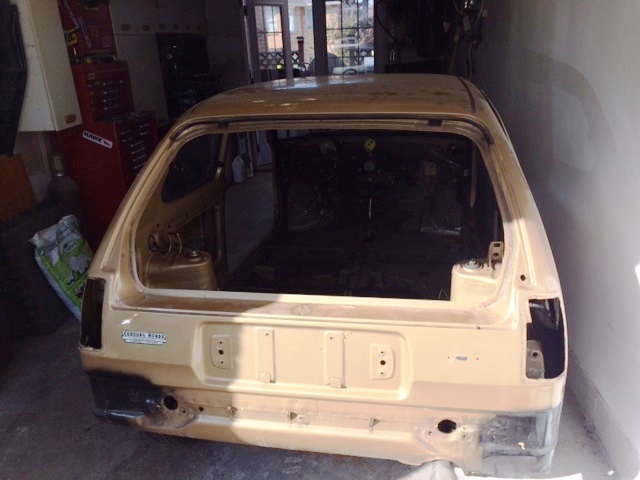

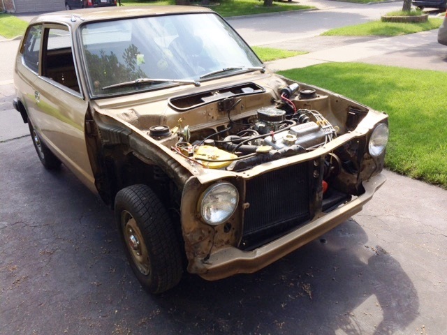

Off to a good start, one of the fenders has been off for two years due to an accident in the garage with a sheet metal brake, So sad.

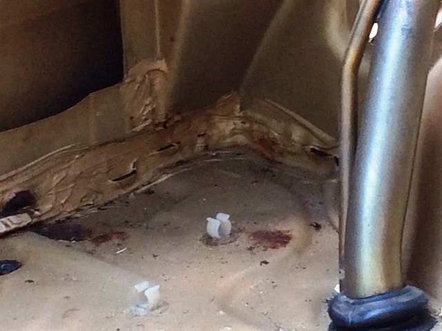

Its apparent this golden boy was in an accident in the front and the back on the left side due to the the twisted metal and abundance of filler found in the door pillar and the number of mallet dents on the inside of the rear of the car. The right rocker panel if full of body filler and badly repaired

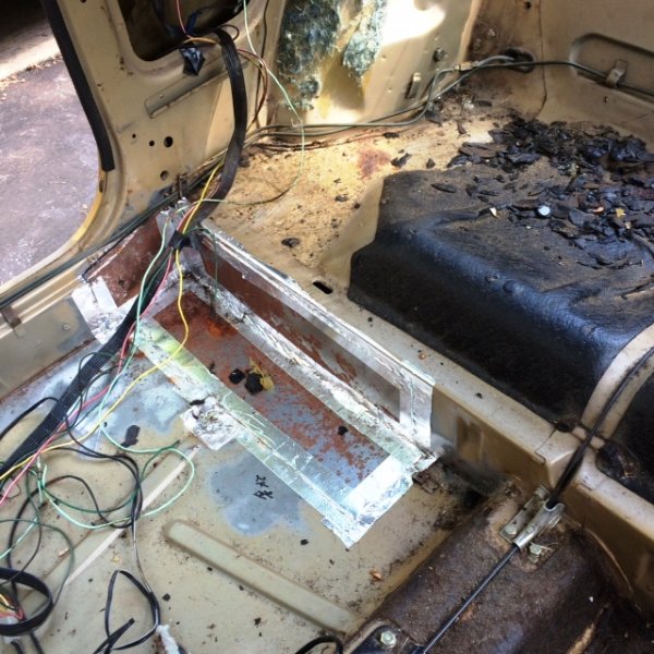

Here we have some foil tape to hold some patch's I made about 4-5 years ago to fix the floor, but due to some health issues had to stop. Somewhere their are pictures where the Honda Dealer I bought the car from had used screening and tar to disguise big holes in the car under neath.

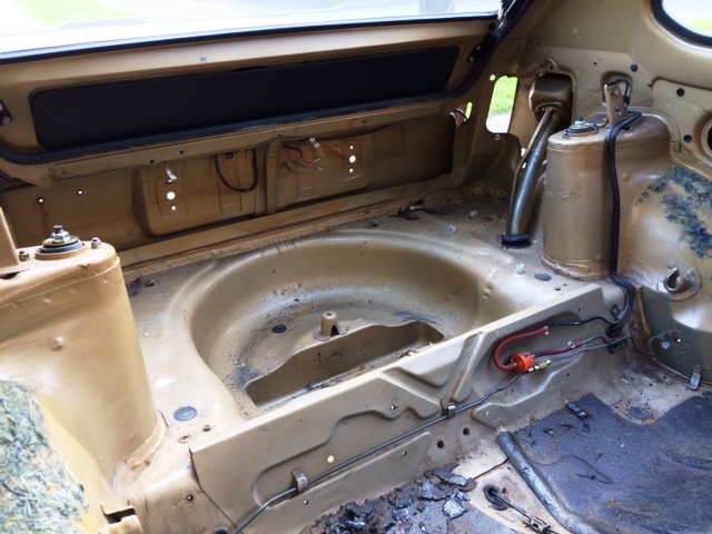

The spare tire recess is in really good shape for an Ontario car, my last one had holes to be patched. The seam around the back of the car is swollen with rust from the inside, you can see it peaking through the seam sealer in the back.
