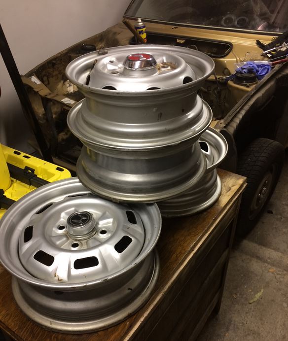

While working on my car a chap came by my house that saw my car in the garage earlier and offered to sell me some original wheels and caps. Never used as they put allows on the car after they purchased the car.
Turn out he used to work for Honda Canada. Funny bit is he has an N360 that I spotted while out on a run.
I hope to get the other three rims soon.
Nice guy
I finally received the other 3 wheels one is less the cap, but instead he gave me the total of 9 wheels. 3 of which are 1stgen Accord wheels. Mint condition.
I commented how one looked like the spare from the Civic as it has the full treads. They are BF Goodrich.
That's when he told me the wheels are of the Honda official Pace car 🚗 for the CASC Honda BF Goodrich Canadian Run-Off series. I believe it ran for 7 years and involved 400 drivers. I have a picture from one of the races in colour.
He purchased the pace car from his employer when the series ended. They had put Honda alloy wheels on the car.
I don't think he has the car.
It's odd a Honda tech guy driving a Chrysler van and he has an N360 with flats in his driveway.

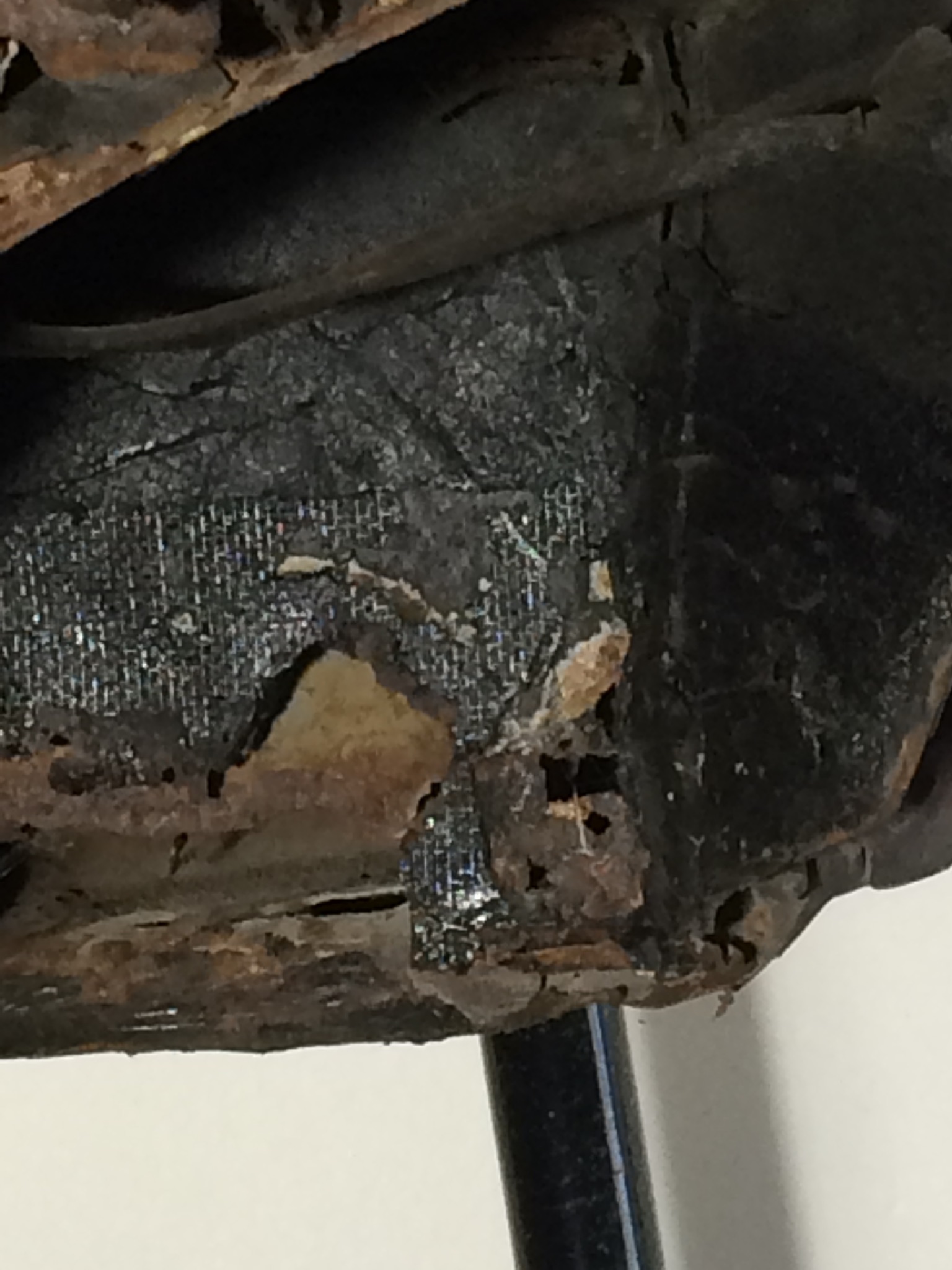

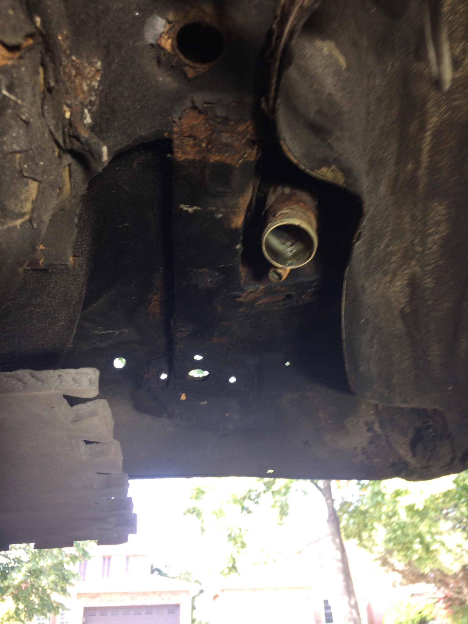

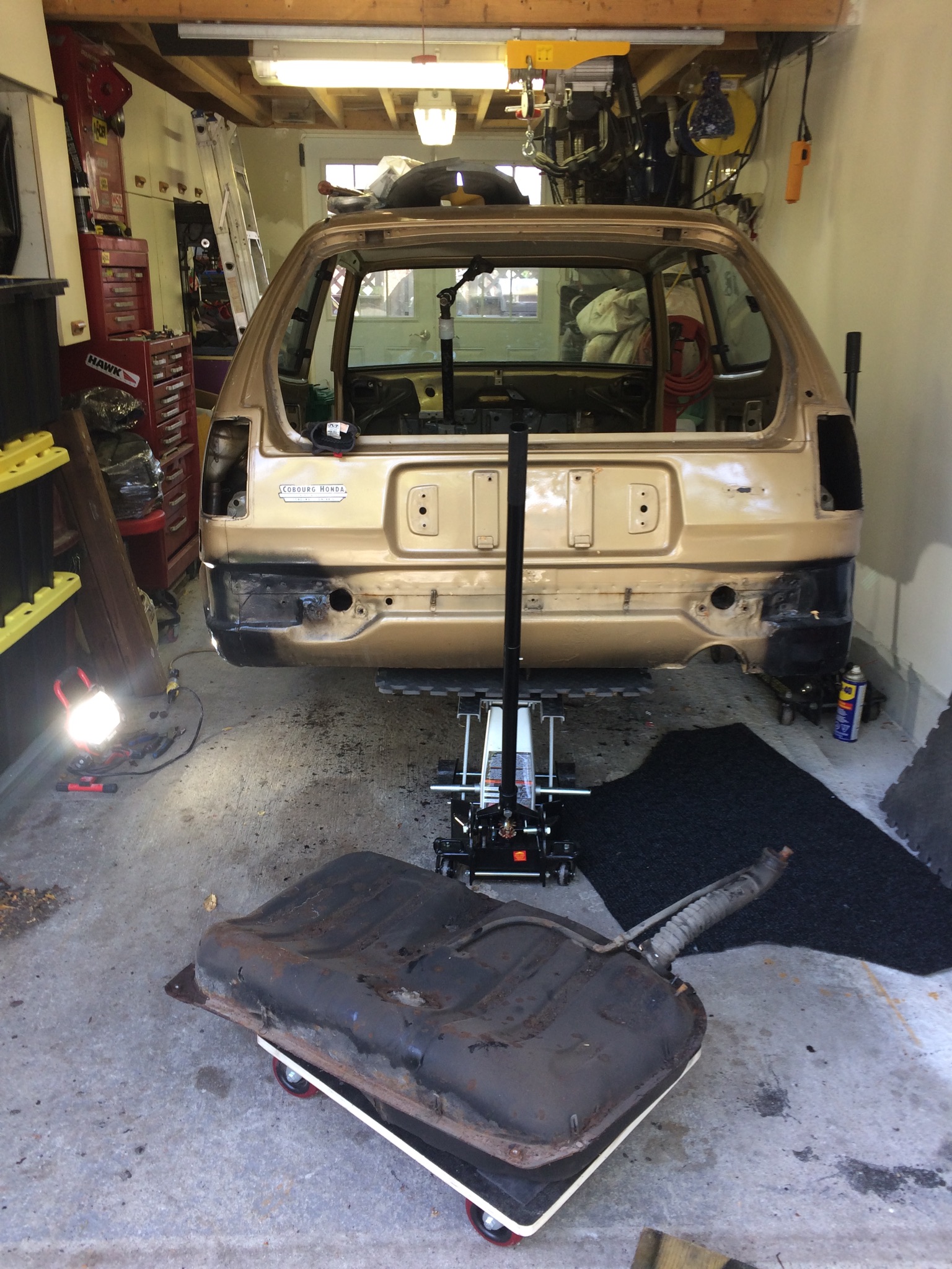

Finally a noticeable difference. It's like pulling teeth to get anything done. But what a mess I made. Seems while draining the gas tank took forever considering it said empty.
The tank that keeps on giving

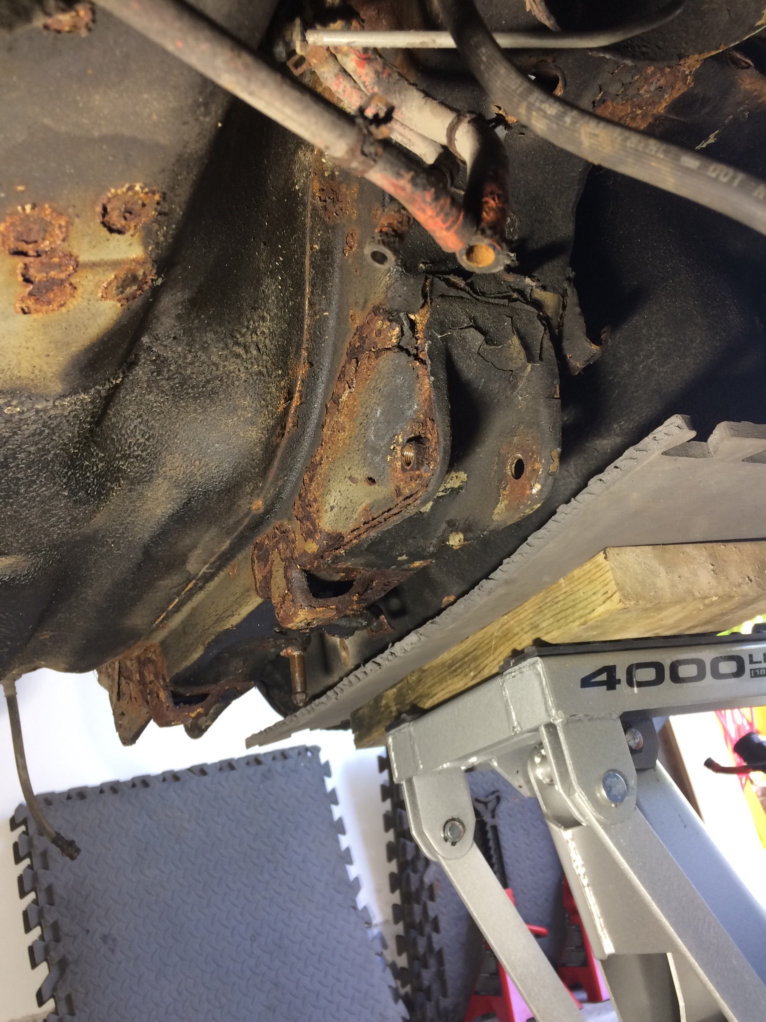

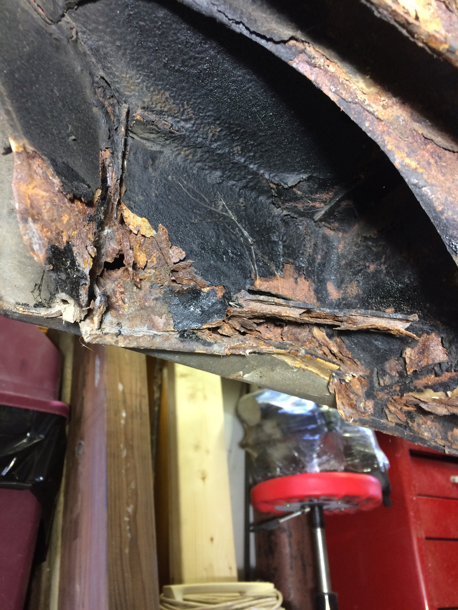

Tenderly I took out some nasty rusted bolts holding the tank in expecting them to break, I used a smaller socket and hammered it onto the bolts. Out they come!

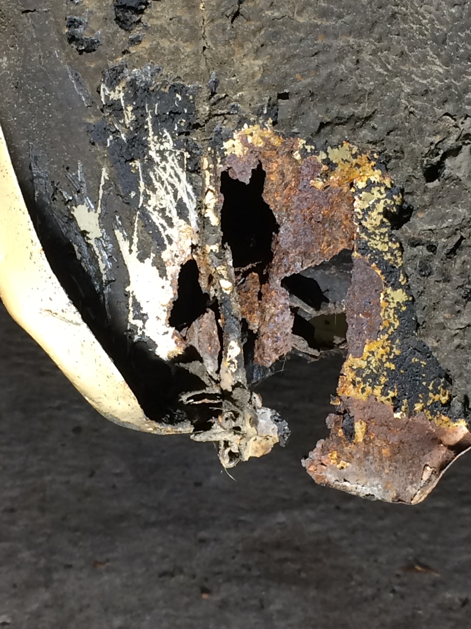

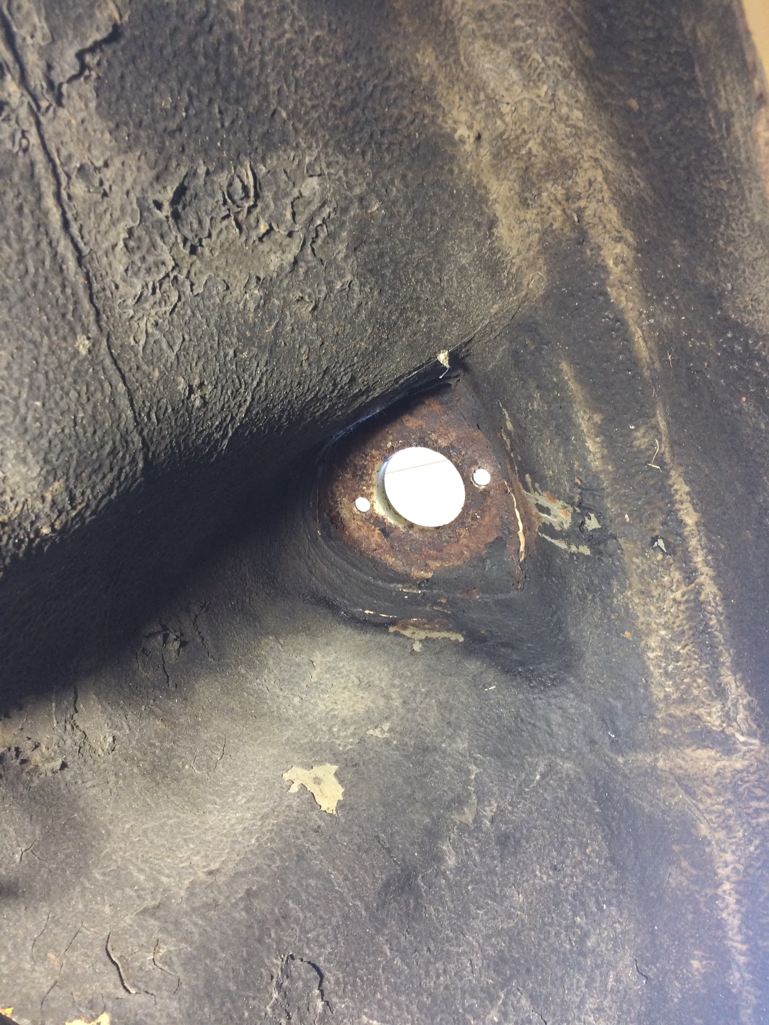

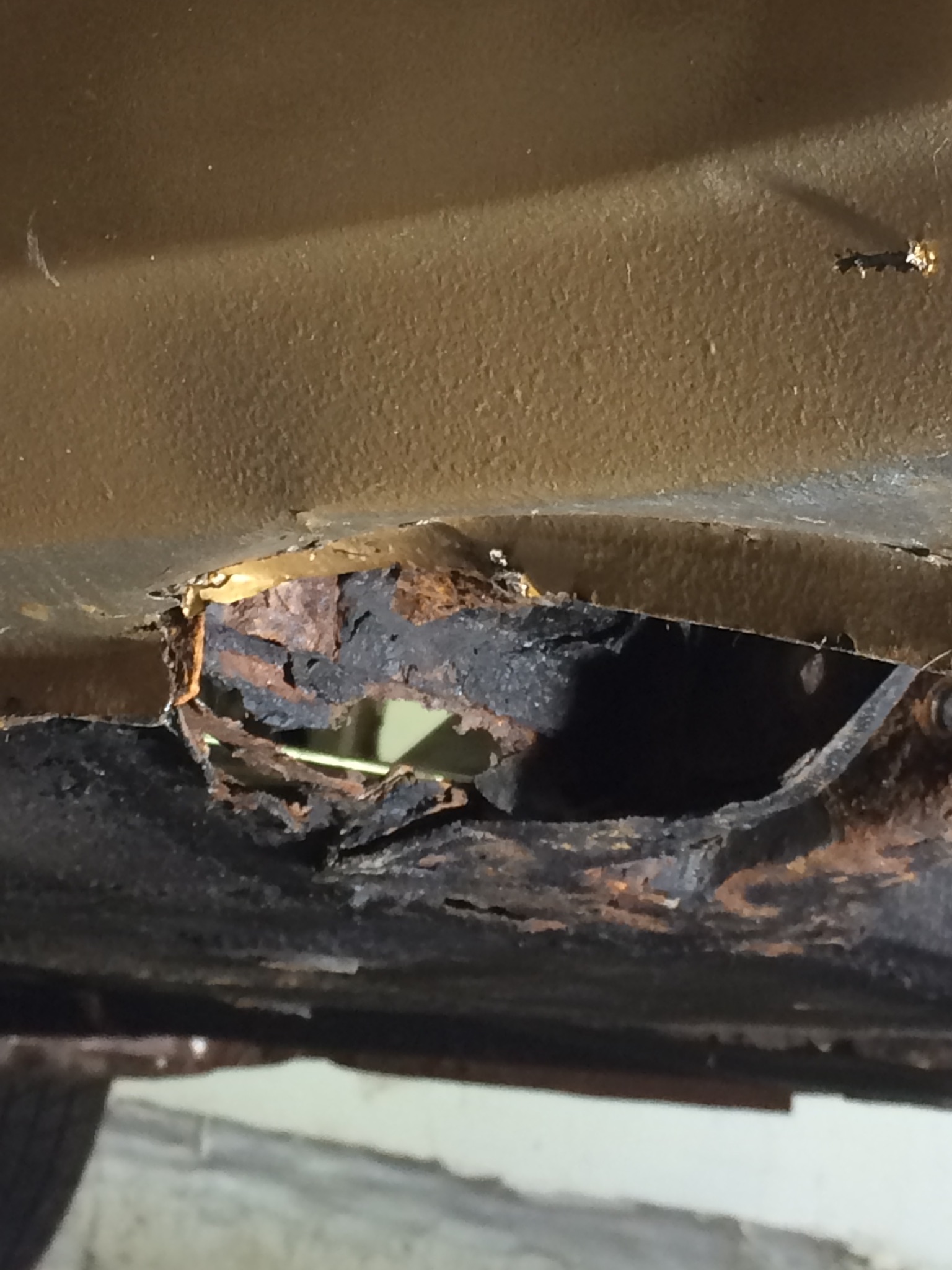

I tried jacking the car up so I could get the rear suspension out and the jack went right through the jacking point and through the bottom of the rocker panel.
Jacking point gone
Jacking point gone

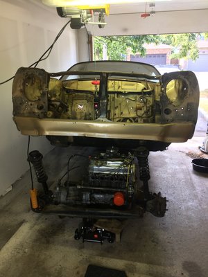

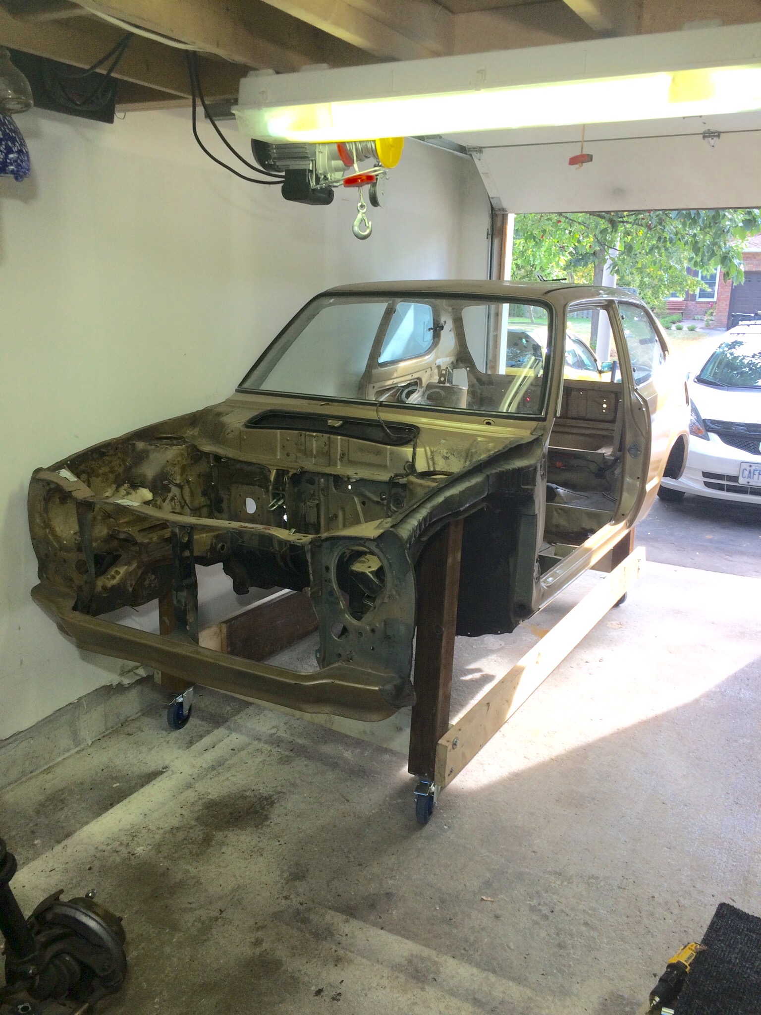

I used my new cable hoist to raise the body off the motor and transmission since my chain and engine hoist is at my sons garage buried under piles of Honda stuff.
Hoist
Hoist
https://www.instagram.com/p/BVh8VAbDWqF ... stgenhonda

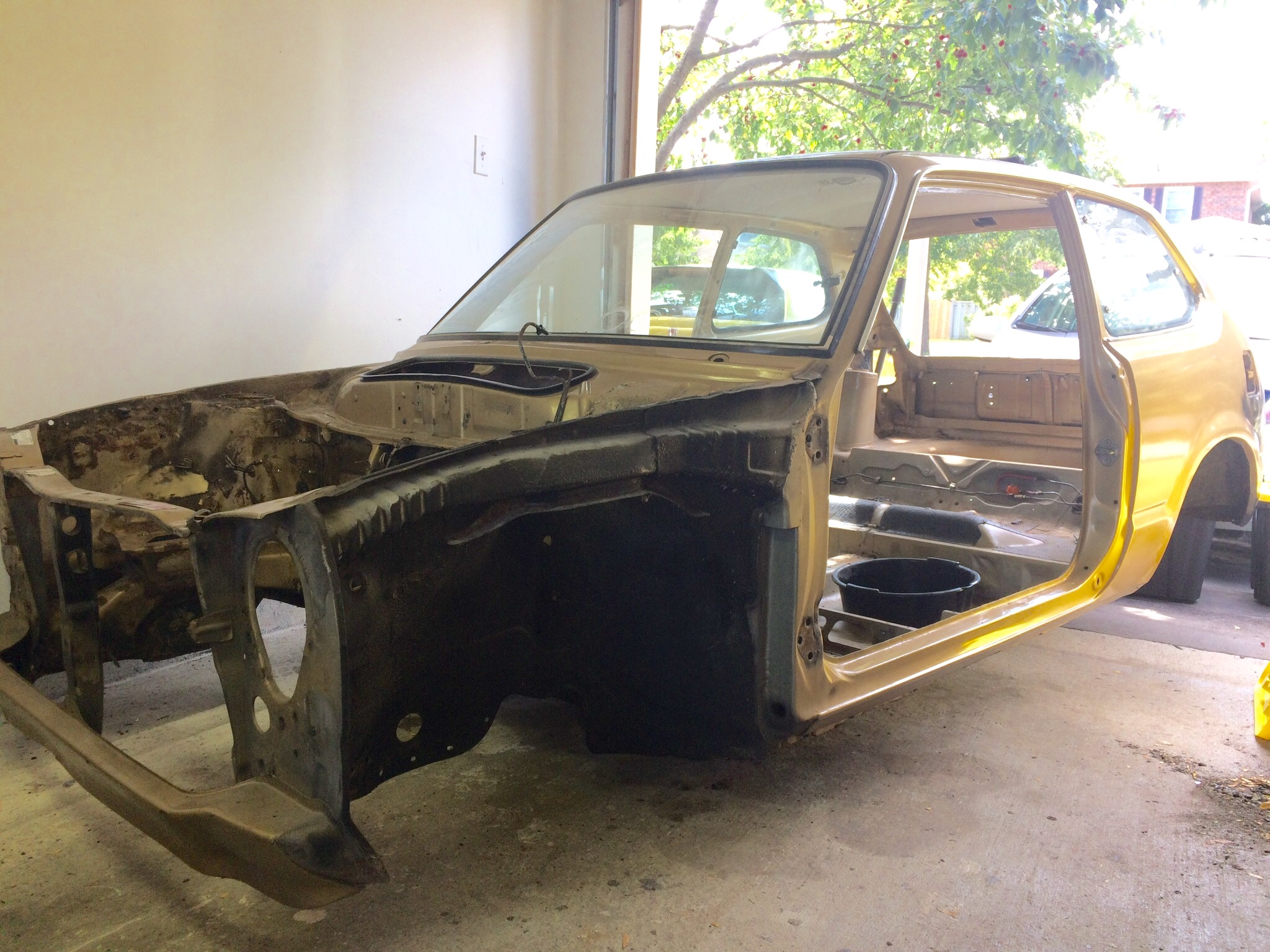

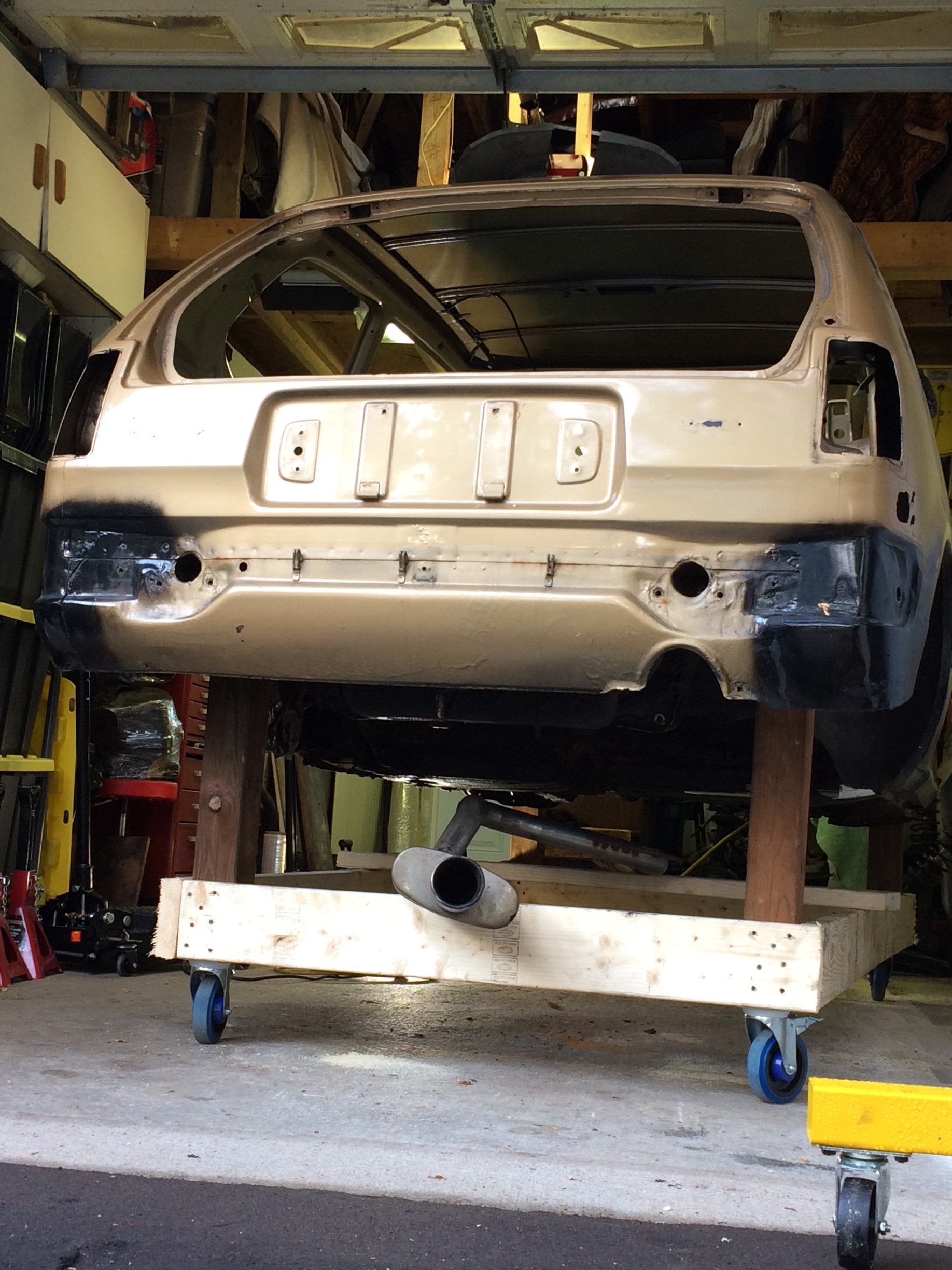

I made a cart from 4x4 posts and 2x6 joists to move the car around and out onto the driveway
Cart
Cart
On dolly
On dolly

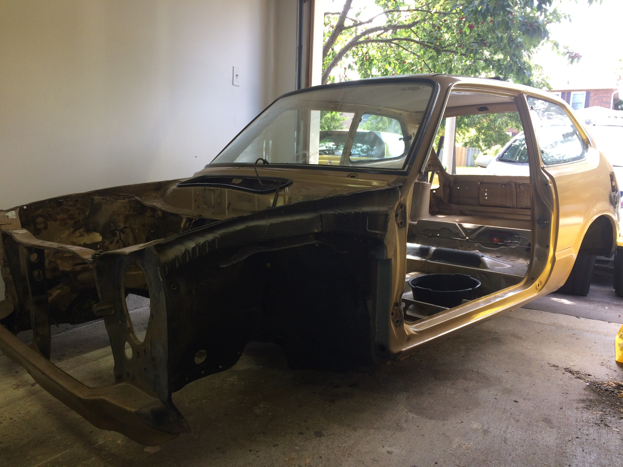

Took a better picture of the chassis cart 🛒 took out the roof liner and the last of the wiring, engine bay is now empty of all bits. Last to is the ⛽️ fuel lines and the brake lines. The windshield is waiting for a hot day to soften the rubber for easy removal.
Up
Up
