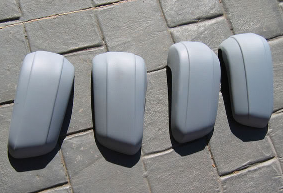

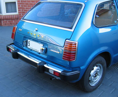

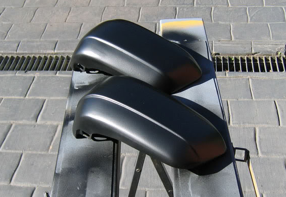

This weekend I repaired my bumper ends and repainted and refitted them. I also painted the bumper over riders/guards that Anthony supplied me. I've painted my bumper ends before, but I didn't do the prep work properly, so the paint didn't adhere, but this time I really made an effort to get it to stick. I used #36 grit to rough up the surface in a big way, then filled any imperfections with this excellent filler from the UK. It's called David's Isopons P38 filler, and it's the best stuff I've ever used, but then again, I've only ever bought auto store filler. The P38 is really easy to sand, and retains good flexibility. I love it. So once I had filled and sanded it back reasonably well, I then sprayed primer/filler on in a generous manner, then sanded it back removing any imperfections, then I did the same all over again until there wasn't the slightest imperfection. I sanded it in the sunlight which helps pick up the lightest of overlooked scratches. So this is where I was at this stage...

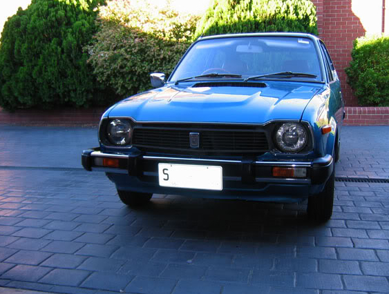

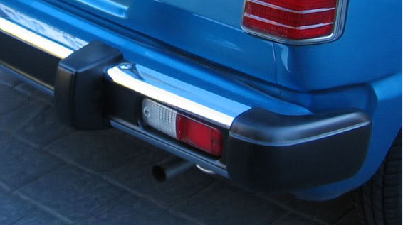

From there I gave them all a coat with a bumper bar and plastic paint in satin black, and this is how they came out...

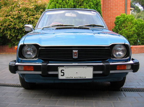

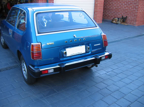

Then I repainted my bumpers, and refit the bumper ends while off the car on a couple of A frame trellises. This is the best way by far to refit them, as it's a real pain otherwise. So this is how it ended up...

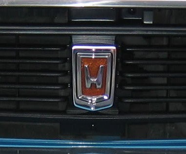

Couldn't wait any longer, so I painted the front grill...
I also polished the gold background on the front emblem. It was pretty deteriorated, so I used some sandpaper and removed some of the plastic, then I used fine sandpaper, followed by ultra fine, then I used a tiny jeweler's mop in the end of my Dremel with the proper light-blue plastic cutting compound and polished it back up. I've done a lot of plastic polishing in the past, so I have a good feel for it, as it's very easy to overheat the polymer and burn it.
