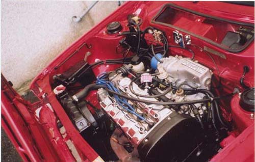

David..do it!! I've just installed a D16Z6(SOHC VTEC)into a 78 hatchback..the twin cam will fit in the 82 for sure..I also have the ZC in my '79 civic(cvcc)wagon and it's injected..less room than the 82 and it fits with a little mods..
no air cleaner

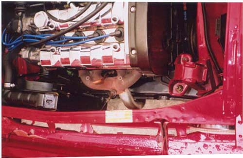

also a shot of the '98 and up civic manifold..
manifold

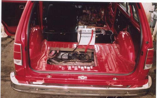

and the only place for the battery was a custom built box in the rear floor..
battery..

Well where do i begin...first of all my name is Justin March..you can reach me at(604)880-1290...The motor mounts we used are the original units from the donor car(89 INTEGRA)the brackets are custom built(look at the SOHC VTEC thread)for a better idea.If you have the means to weld go for it.You should clear the hood, The turbo should fit also(thats the next step for my wagon)My motor is a Jap. spec 1.6litre ZC. factory rating is a 130hp, i've added the air-intake and filter, 2 1/4" exhaust dynomax ultraflow muffler, unorthodox racing underdrive pulley, Gude(Bullfrog) cams and adjustable cam gears,OBX throttle body,The exhaust manifold currently on the car is from a '98 civic hatchback(due to crossmember clearance)but i'm thinking about with a turbo kit.I haven't put it on the dyno yet, but i'm estimating around 155 to 160 hp.I will be running it at the track on the track in june.The axles in my wagon are custom built(i used the integra tranny with the intermediate shaft)so my axles are equal length...they are the integra units just shorthend and re-splined to accept the 81 civic outboards(i did the 4x100 conversion)I have not tried a newer conversion so I'm not sure of the outcome(try this page for a little more help) http://hybrid.honda-perf.org
