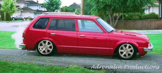

Kevin, with the ZC and a 55 shot of NOS, my '79 civic wagon ran against a '98 M3 and i beat him by 4 car lengths, and the next race was a '88 mustang gt with a 5.0 and he said "he has a 80 shot of nos" but he was even easier to beat..The M3 did a best run at the track of 12.79..so i figure on the street he runs a low 13 sec..if i run more Nos i'm sure i can run a high 12 on the street..
wagon
Justin
