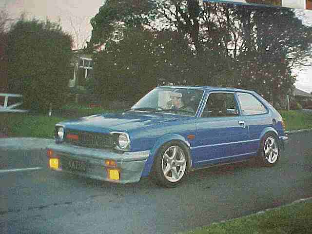

Top of pagePrevious messageNext messageBottom of pageLink to this message   By Charles (137.219.16.107) on Wednesday, February 28, 2001 - 04:36 pm:
This car has one fitted : LOGAN
