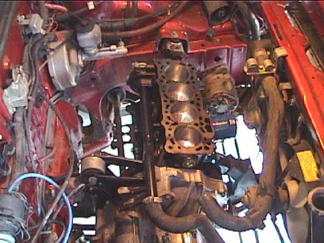

Top of pagePrevious messageNext messageBottom of pageLink to this message   By dennis singley (65.101.0.105) on Thursday, December 27, 2001 - 07:50 am:
Picture of EL-1 block & GJ trans in my 1980 Civic 1300 DX.
Top of pagePrevious messageNext messageBottom of pageLink to this message   By John S. (207.160.161.161) on Thursday, December 27, 2001 - 02:44 pm:
That car is going to be a cruisemobile with the gearing in the GJ gearbox, try around 2700RPM at 80 MPH. I'm going to use the same box behind a hopped up "canadian head" EF1... but you will have more torque with the 1751. Looking good. It's a shame how few people realize how good the 80-83 Civics are...but then again, maybe it's a good thing.

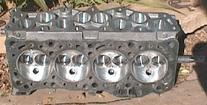

Top of pagePrevious messageNext messageBottom of pageLink to this message   By dennis singley (65.101.1.142) on Saturday, January 12, 2002 - 05:08 am:
Here's a picture of my EL-1 head.

Top of pagePrevious messageNext messageBottom of pageLink to this message   By quikrick (63.204.16.66) on Monday, January 21, 2002 - 05:21 pm:
Dennis sent me these images of his EL1 head. VERY nice work!

Top of pagePrevious messageNext messageBottom of pageLink to this message   By John S. (205.184.255.64) on Tuesday, January 22, 2002 - 05:05 pm:
Dennis,
You need to taper those ports back at least an inch to an inch and a quarter. It needs to be more smooth a transition, other than that suggestion they look great.
