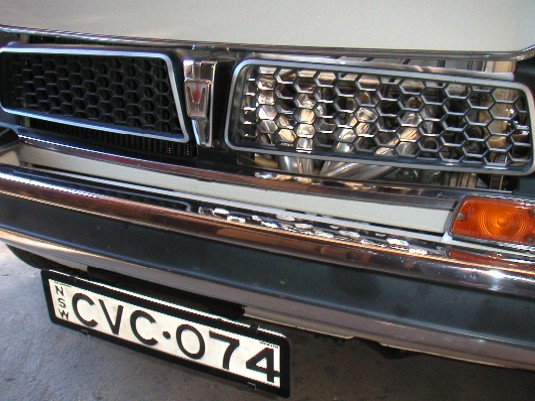

| By DaRk (66.50.182.60) on Monday, July 11, 2005 - 07:52 am: |
Nice Carbs...
I like the front licenseplate.....Gotta love the headers tho... B-D
| By Glenn Biscan (211.30.144.154) on Monday, July 11, 2005 - 04:56 am: |
looks really good. Congrads
Nice headers as well, the coating on them looks the goods.
| By jim_mac (211.31.11.119) on Sunday, July 10, 2005 - 05:33 pm: |
Finally got the Keihins fitted. I consider myself extremely lucky to first find a set and then to find a couple of parts to make the things work.
I must thank Adrian for all his advice regarding the hoses,fittings, brackets and where to get the gasket kits etc,, (it's good to live close to the guru you can just pop in for advice) The gasket kits by the way are Goldwing GL1000 motorbike fittings and cost me $A75 each but well worth it.
The motor was re-built by Wayne Griffiths. He used my EB1 block and EB1 head which was ported and the valves were modified for better gas flow. A EN1 crank & rods are installed and increased capacity to 1338cc. Watson cam 26/66 and a Hurricane 4 into 1 header included, flywheel lightened and everything balanced.
I had Hanny's Performance in Sydney pull the Keihins apart, clean and fit the new gaskets, install the electronic ignition from EN1 and that's about it.
The car is going great, the responsivness of the accelerator is un-believable and with the cam and torque of the crankshaft cutting in my EB1 is very exciting to drive. I took some pictures
