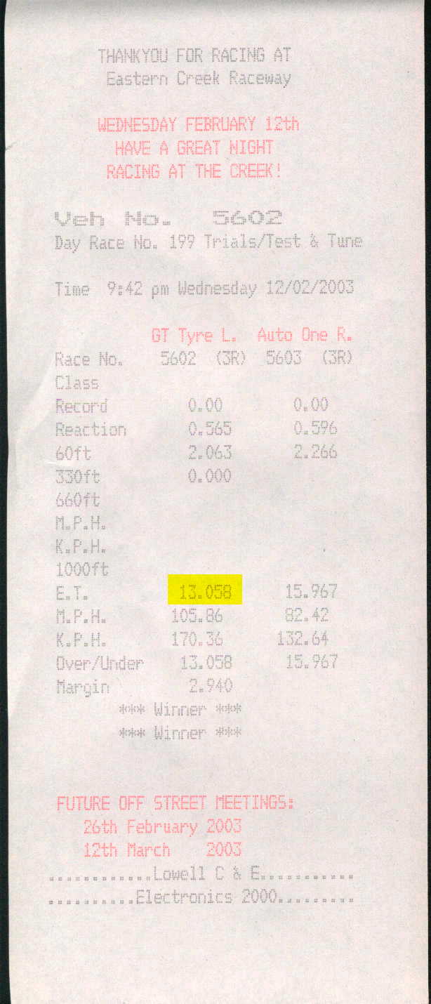

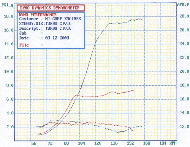

By Angus Button (Stu88y) (202.7.88.184) on Tuesday, March 23, 2004 - 10:41 pm:
Well I think I can say that I have one of the fastest ORIGINAL engine 1st Gen Civic and it is also 100% street legal. It is not really a drag car as it is built for circuit work.
I have just increased the exhaust size to 3" and installed an electronic boost controller. I hope to run a max of 20psi. I am racing again on the 5th April. Will keep you all posted.
Angus

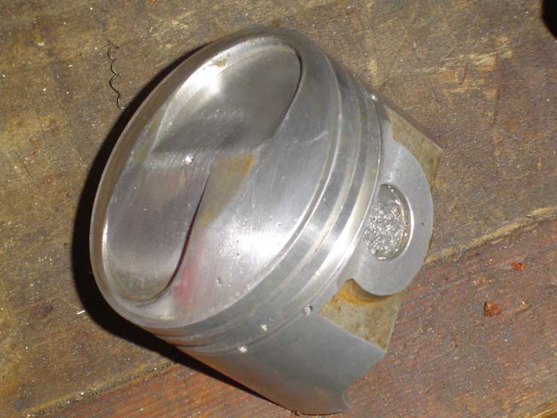

By Todd (152.163.253.2) on Thursday, January 29, 2004 - 04:40 am:
Those are definately not Goldwing pistons. Very custom. It looks like a RS head to me, though I've never seen a Mugen head. The one thing that does stick out is that the head has been skimmed...A LOT. Whatever you do, don't let that thing get hot once its done! Wow, those cam lobes are almost round! That thing'll probably turn 9000rpm.
On second look, those exhaust ports are huge, and the chamber is shaped differently that heads I've seen. It may indeed be a Mugen. Adrian?
By Chris Elder (211.30.173.156) on Wednesday, January 28, 2004 - 08:50 pm:
i found all that gear in my dads garage ;) it has been sitting there for 20+ years...
Dad told me it was Mugen.. it looks quite similar to the head that Adrian Frankel has (BELOW)... I had a look at the Ports and they appeared to be larger than standard head (without any modifications)... So I would put foward the question of it being an EB3 head to him and see what he says.
As for the pistons, he told me they were custom? lol, but it all depends how much "custom he means"... if custom is CUSTOM or pulled out of goldwing.
Camshaft holder = Cam-cover / tapet cover? (the black and metal cross grill thingy).... unfortunately i dont have it, i asked him whether he had it because i myself too was looking forward to seeing Mugen in bold letters, but he said no - so i guess ill be using a standard cover that ill polish / chrome plate or spray ... etc.
By H (24.67.134.220) on Wednesday, January 28, 2004 - 03:23 pm:
What makes that a Mugen head?It looks like a regular EB3 to me.Do you have the matching camshaft holder for that head?What pistons are those?Goldwing?

By Angus Button (Stu88y) (203.12.97.47) on Wednesday, January 21, 2004 - 05:41 pm:
Hi Every one. The best time I could manage on Goodyear Eagle tyres was 13.3@110MPH. This is the best MPH I have ever run but traction is my biggest issue now. I am going back to the Dunlop Type R street Legal slicks for much better grip.
Will let you all know how I go when I race again in a couple of weeks. I was still happy with the times on the standard road tyres.
Cheers
Angus

By Charles (152.91.9.8) on Thursday, December 18, 2003 - 05:36 pm:
Zippy,
Blue lines-High boost tune, Red lines-low boost tune.
Top graph, turbo Boost pressure in psi (LHS) the high lines, Air Fuel Ratio (RHS) the bottom lines. Speed on bottom axis.
Bottom Graph, Power and Torque VS speed

By Zippy (Zippy) (67.106.175.3) on Thursday, December 18, 2003 - 06:24 am:
Would you please explain what the four lines on each of the graphs represent. Are they different gears? If so why do the all show the same maximum velocity? Or, is the velocity scale actually an RPM scale and if so what is your redline?

By Angus Button (Stu88y) (203.12.97.112) on Wednesday, December 17, 2003 - 04:19 pm:
As promised here are my Dyno figures on 18psi.
Dyno1
Dyno2
Regards
Angus
