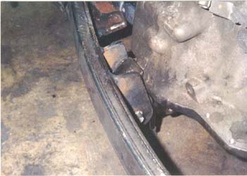

By Justin (24.69.255.236) on Saturday, January 04, 2003 - 10:47 pm:
You wanted pics!! Here you go..these are of Cher's 78' civic with the sohc vtec(93')and si tranny(88')
pass mount
pass mount 1
pass mount 2
pass mount 3
driver mount
driver mount 2
driver mount 3
driver mount 4
driver mount 5
front mount
x member
x member installed
steering box mods
upper rail mods
upper rad hose
rad installed
motor installed
oil pan before
oil pan mod
By David (Daviddoesdallas) (66.190.79.30) on Sunday, January 05, 2003 - 12:28 am:
Did you really have to do all that cutting to fit that motor into a CVCC??
By Justin (24.69.255.236) on Sunday, January 05, 2003 - 08:52 am:
That is in a 1200 not a cvcc, in my cvcc wagon i'm actually running a twin cam integra motor, there was not as much cutting involved, I'm still running a stock rad, the only real trimage was the upper firewall and the steering box, and not forget i also had to have a set of axles custom made(the integra runs a intermediate half shaft and equal length driveshafts)

Wow, nice work. That engine sits REALLY low.. Any problems driving it around town?
About the mounts, so you hooked up the axels and hung the motor in the engine bay then just trial and errored some metal mounts in? I suppose you eliminated the center cross brace that the 1200 sits on.

By Daniel Andersen (166.82.55.78) on Sunday, January 05, 2003 - 02:35 pm:
my engine sits about 9 inches off the ground at the bottem of the oil pan. my cross member looks very similar to that justin, except mine uses a round tube instead of the RHS.

By Justin (24.69.255.236) on Sunday, January 05, 2003 - 09:17 pm:
Eaglesean, the engine actually has quite a bit of ground clearance, the x-member from the 1200 is gone, the oil pan was modified in order to clear the radius arm(If the the car was stock height or the engine sat higher this would not need to be done)The x-member was actually not to bad to make, on my wagon i'm still running the stock x-member..Drop me your e-mail and i'll send you the info on the brake conversion.
