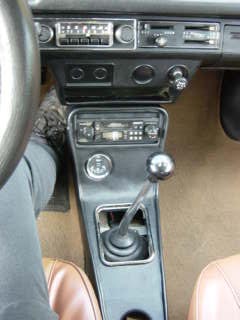

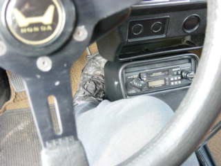

| By shreck (66.185.85.79) on Thursday, June 19, 2003 - 05:54 pm: |
Well here it is with my big foot in the picture.
I put the heater to defrost, it gives me a little more room.

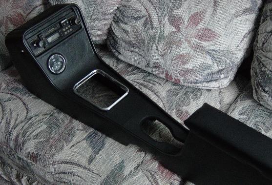

That's a wide console
you will have to get used to it..On Twyla's convertible I have the factory roll-top door console and it's tight with just that one...
| By shreck (199.243.98.218) on Thursday, June 19, 2003 - 09:17 am: |
Opps missed the picture
Here we go.
| By shreck (199.243.98.218) on Thursday, June 19, 2003 - 09:15 am: |
Here is a picture of the console.
I was fitting and making a dry run before I take it out on the road. Insured today Woohoo.
It fits up under the tray below the radio.
I will try to take some pictures of it in the car with my big feet tonight Hehe.
I also have to modify an old spare air cleaner to fit the Webber until I can the proper one.
When I asked for insurance they want more pictures of the car, they must think the car is worth thousands. If it got written off today I would probably only get $50.00cdn that’s about the cost of 10 dozen donuts and a cup of coffee.

Shreck, I can't say I've had that problem about my foot getting caught, but then again, I haven't done anything but move my car around the yard yet, still waiting on insurance before I can drive it on the street. I just kept trying to find a comfortable position not in the way of anything. Wasn't too easy for me (6'5", size 13EEEE shoes). When you say center console, do you mean the one around the shifter, or the one on the floor under the dash?

Anyone have problems going from the gas pedal to the brakes with a center console. My foot gets caught on the back of the console and that darn wire from the bottom of the heater box.
Now be nice, my shoe size is 91/2eee.
