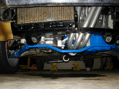

| By jms (132.38.190.10) on Monday, August 25, 2003 - 08:25 am: |
Jared,
did you use your original crossmember in the front, if so how did everything clear could you post a pic, you must have cut it at least right? You have the 1.6 FI, 1,5 FI or carbed motor in it?
| By twospeed (205.206.249.15) on Sunday, August 24, 2003 - 09:43 pm: |
I should also take the time to thank Justin for his help. I would not have been able to do the disk conversion with out his E-mail teck support. Thank you.
| By twospeed (205.206.249.15) on Sunday, August 24, 2003 - 09:21 pm: |
I'm not sure what the front valance is. If its the (air dam?) I cut it out when I was doing the swap. I will cut out one from a doner car and bolt it on. I plan on getting a set of brembo cross drilled disks too. The rears are still at the machine shop, and not yet on the car.
