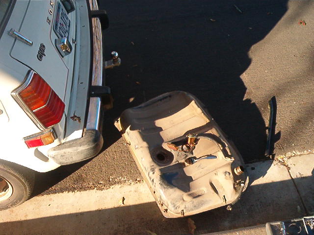

Well Ive been flushing it and its actually not that bad, it cleaned up pretty good. The stuff inside sticks and is hard to get out. I cleaned it and it doesnt look like it was rust, because the inside was nice and smooth afterward. Ive been flushing it with solvents and water. Im going to get MARINE CLEAN from POR15 they say you can add as much as 10 times of water to it and it still works good. SO hopefully that and then running it thru a parts washer machine for an hour or two or more will do it. Ill let you know.

That is some pretty nasty crud. I've seen this before on old tanks, usually with cars that have been sitting for a long time. Don't touch any old fuel or crud, as that smell is really hard to remove from clothes and skin. I've heard good things about the POR15 product, but undertand you need to remove all the crud and loose materials for it to do any good, which is pretty hard to do with an old tank. If you go with the old tank, buy a box of BB's, the kind you use with a BB gun, and pour those in, seal the holes with rags and shake the tank as best you can to remove the junk. If the tank was not leaking before, just go with it, and use it. Change the filters often, and install a filter near the tank so the line does not get more crud in it.

In the colder climates water always gets in the tanks due to condensation. My cars tank was so bad that I had to change the filter 5 times till I finaly took it off and got it flushed. Even after it still was not the best. For about 150 they can line the tank. I this works well.

Rust denotes water, plain and simple. So some how water managed to get into the tank.

Jared-I feel your pain, man. If that's what the inside of a fuel tank looks like in Texas, YIKES I'm scared to see what the inside of my Ontario fuel tank looks like!
Think I'd go with the POR-15 fuel tank kit as others have suggested. At a place local to me here in Ontario, the kit sells for $85 CDN. I'm quite sure you lucky folks down in The States will get it cheaper...

Jared, it's a dry heat outside of your tank, but there's different conditions inside your tank. Condensation can form inside a tank, especially if the car has been sitting for a while with half a tank full of fuel. If I were you, I'd go with the POR-15 tank resto kit. Cutting and welding a gas tank can be very dangerous. It's very difficult to get all the fuel vapors out, and the slightest spark can cause an explosion. If you really want a bigger tank, there's companies out there that specialize in custom fuel tanks. The one I've heard of is called Rick's Hot Rod Shop, and they're even in Texas. There's probably more places around if you want to shop around for the best price. If you really want to make your tank into a higher capacity, have it done by a professional who has the equipment and practice for welding tanks.

The car is mint the outside of the tank is mint and Im in TX??? its supposedly dry heat out here so what the heck, its like this in both my TX cars.
I have heard good stuff about the POR-15 tank resto kit. But heres my plan, if it doesnt work oh well I have a spare tank-cut a square large hole in the bottom, totally bead blast inside the tank, and then weld it up with about an extra inch or so for added fuel capacity. How does that sound, good idea?

As to that fuel tank ... WOW! I've never seen a tank rust like that ... must be a cold weather thing

Jared, hope you get a new tank! That one is really nasty!

I may do the fuel tank resto thing, but would like to find a non-rusty one, I took one off my parts car and its even worse.
