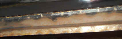

By shreck (24.112.121.191) on Saturday, January 24, 2004 - 02:59 pm:
Hey Keil
I took some pictures and measurements of the slice of rocker panel I have.
If you have any questions post them here or email me, I will be glad to help.
dwg
rocherslice
rockerside
By shreck (199.243.98.218) on Friday, January 23, 2004 - 11:43 am:
Keil
To do the inside it is a major job.
First I removed the interior and the seat rails, it makes it easier to remove the inner rockers. Drill out the spot welds and try to remove the section with a very sharp wood chesel in as big a piece as possable. Try not to drill through to the outside. But if you do you can use the holes to weld the new piece back in. I used a piece of Vynial flooring to make a pattern as it is stronger than cardboard and it can be cut with tin snips too. Remember when you make the inner piece to include the bit that goes below the floor. Also when I made the outer rocker I made the bottom edge to wrap under and sandwitch the floor tab to the inner rocker.
