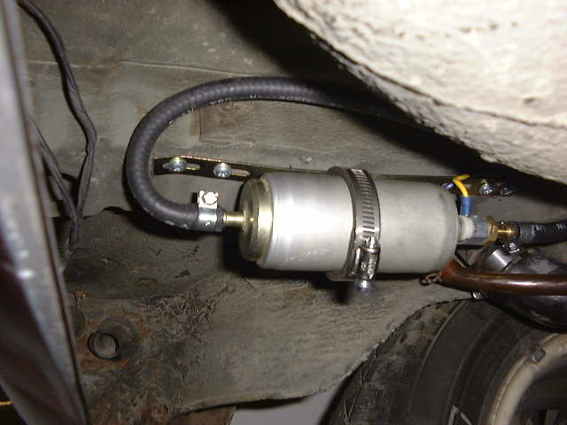

Thanks for the pictures Justin.

| By Justin (199.60.112.10) on Thursday, January 15, 2004 - 02:25 pm: |
When you do the efi swap, you should have a Main Relay, that runs the fuel pump, it will suffice

im going to use the original fuel line as a return since it is already there and comes out on the side of the engine i need it on. got a Walbro 255 lph pump($20 brand new!!!) just need some fuel injection line and a filter. im going with hard lines because the auto parts store wants 4.50 a foot for fuel injection hose.
justin, did you use a relay to activate the fuel pump? i have a chassis harness from a crx si that im "grafting" into the wagon and was wondering if the stock crx fuel pump wiring will be sufficient
| By Justin (24.69.255.203) on Thursday, January 15, 2004 - 08:50 am: |
The pump is located on the rear left of the car(just behind the wheel)the fuel line is run thru the original return line location and follows along the driver's side of the car..

pretty much just a lot of hose, and from what i've searched on the subject any inline fuel pump should do, Justin used one from a ford f-150.

Hey Justin, please get some pictures on how you run the fuel lines and where you mount the external fuel pump. Please email me. Thanks again.
