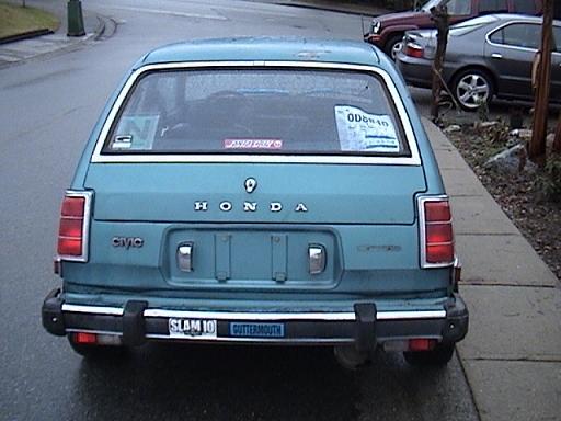

| By farenheight101 (24.69.255.203) on Thursday, January 15, 2004 - 02:15 pm: |
Hey guys, finally got my friend to whip out his digital camera and go nuts on my civic.
The mods done so far are:
-4X100 coversion
-'92 civic cross drilled and slotted front discs
-'86 prelude si cross drilled and slotted rear discs
-Russel steel braided brake hoses
-Optima redtop gel-cell battery
-EN1 swap with 5spd conversion
-4X100 to 4X114.3 1" thick hub adapters to fit:
-14X6" Appliance slotted mags with:
-195/45R14 Toyo Proxes T1-S tires
-Gorilla mag lug nuts
-Roof liner upholsered with green camoflage
-Dellorto 32mm DHLB's with K&N filters
-APC "NextLevel" coilover springs (seated on the perch ring which is held in place with a rag sock for cusion and centering...hehe)
-Sports goods Type-R pedals
and I guess thats about it...lots more to come though like roll cage, sparco seats, short shifter, full exhaust with headers, flexpipe, 2" piping, mandrel bends, and an Apexi N1 universal muffler.
Thanks alot to Justin, Twayla, and Puff for all the help!
