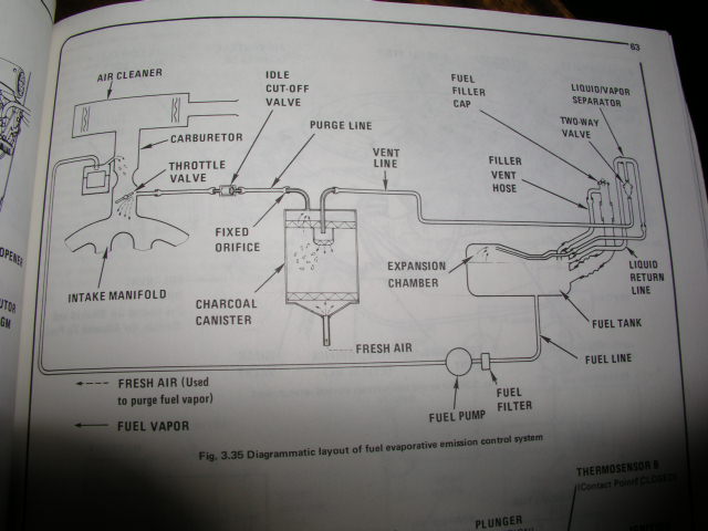

Hey Jared, I was looking through a manual tonight, and I found this diagram:
EEC
I know it's been a while since you asked about it, but I didn't think I had it. This help?
By 79cvcc (69.19.0.1) on Monday, February 09, 2004 - 03:02 pm:
number 2 that you have marked is the line that goes to the carb i just got done with my cvcc's tank Jason

By jms (66.242.1.118) on Saturday, February 07, 2004 - 10:31 am:
prob is I put a CVCC tnak on a 1200, so can you tell me how these lines go?
