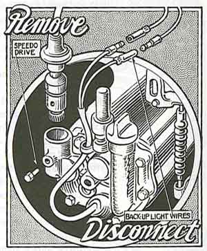

| By shreck (24.112.121.191) on Monday, March 01, 2004 - 08:05 pm: |
It's from a Honda manual. It's kinda crazy and cool. "How to keep your Honda Civic Accord Prelude Alive. A manual of step by step procedures for the complete IDIOT" by CISIN & PARVIN
| By Jonathan (68.193.10.141) on Monday, March 01, 2004 - 07:55 pm: |
It looks like that picture came from "How To Keep Your Honda Alive". It's a great book, filled with all sorts of those pictures.
| By bwilborn (168.103.206.30) on Monday, March 01, 2004 - 06:14 pm: |
schreck, where did you get that groovy pic of the disconnect? That's got to be one of the most artistic auto diagrams I've seen.
