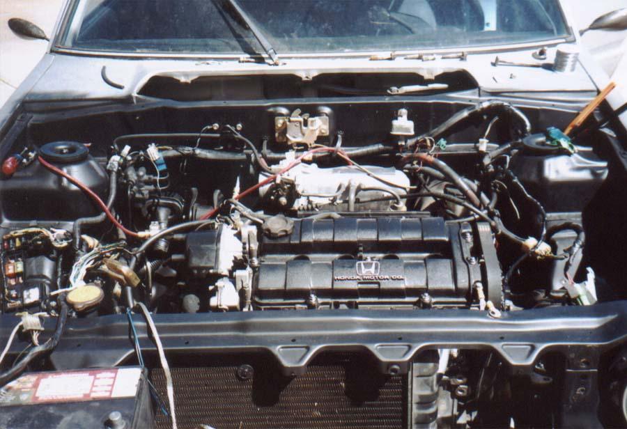

| By Colza (210.54.193.198) on Saturday, March 20, 2004 - 04:15 pm: |
Just quickly, what do your engine mounts look like now? And what do you have to do to your poor driveshafts???
| By Parker (24.98.213.4) on Saturday, March 20, 2004 - 12:27 pm: |
thats a DOHC ZC motor, 1.6L 137ps, 106lb-ft stock
it was no picnic getting everything in, and despite what you may hear about the wiring, the fuel line plumbing was the hardest , most frustrating part of the whole swap.(to me at least.
| By DåRl{ (66.50.183.94) on Saturday, March 20, 2004 - 12:24 pm: |
Hey Parker...What's that engine You have mounted in there?
| By Parker (24.98.213.4) on Saturday, March 20, 2004 - 11:09 am: |
well there she is, just waiting to be figured out...
