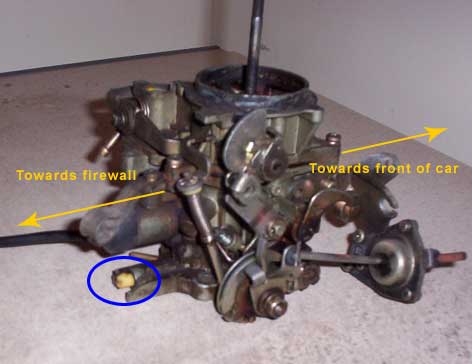

By felipe casanova (200.74.71.51) on Friday, April 23, 2004 - 10:02 pm:
hey a question....in that pic that lazy posted all right that is the air/fuel screw, but which side i have to turn the screw to make it richier mix or poorer? according to that pic should be up or down?

Good lord, I was thinking, my engine looks nothing like that, then i realised that entire thing is just the carby. Oh dear, i'll give it a shot when my dad gets back on monday, he at least knows what he's doing.
Thankyou very much for the diagram, thats a big help.

By lazy (165.228.57.19) on Friday, April 23, 2004 - 05:29 am:
an opportunity to use my new toy :)
behold

By lazy (165.228.57.19) on Friday, April 23, 2004 - 04:28 am:
on the firewall side at the base. It may be covered by a plastic cap.
