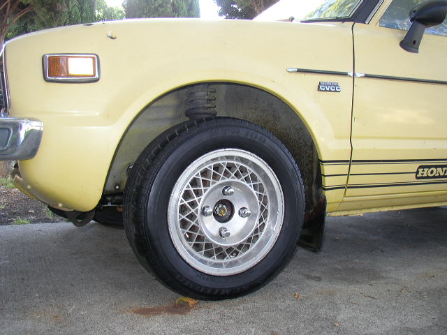

By Quikrick (Quikrick) (63.204.16.66) on Wednesday, July 28, 2004 - 09:03 am:
Jonathan, the tires are 185-60-13. The stock ones are 155-80-13, stock are taller.
That's the stock ride height for the wagon. I guess with the lower profile of the 185-60s it "looks" kinda high.

By Jonathan (68.193.10.141) on Tuesday, July 27, 2004 - 06:40 pm:
Hey Rick, what size tires do you have on your car? Is that the stock ride height for the wagon? It looks rather high. The wheels look good though, congrats on your find! Any ideas on what to use for center caps?
By Quikrick (Quikrick) (63.204.16.66) on Tuesday, July 27, 2004 - 06:00 pm:
I always seem to stumble upon "one more thing I can't live without"!
These are old school Appliance wheels, popular in the '70s, 13"x6" with a 35mm offset. The offset is borderline, might rub a bit if I lower the wagon too much.
