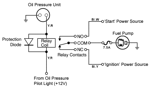

I'm wondering if this would work like the holley "Oil Pressure Safety Switch" (P/N 12-810) and be a cheap alternative to the US$40+ OE fuel cut off relay. If I have the logic correct, then the only reason it may not work would be the rate at which the oil pressure drops after engine shut-off. How long after the engine stops does the 'oil' pilot light come on?
