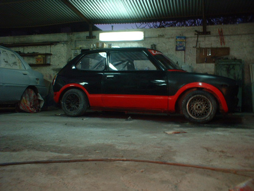

By felipe casanova (200.74.70.161) on Tuesday, June 22, 2004 - 05:06 pm:
well guys here are some pics of my friend eduardo the car is getting out of the paint shop the car was blue but now is black with red

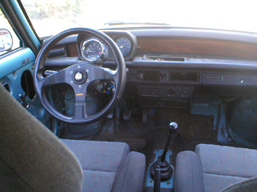

My car with new steering wheel

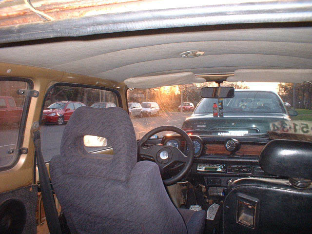

here we go with some pics of my seat swap....still have to put the passenger seat!

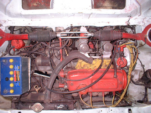

By juan salguero (68.123.154.115) on Wednesday, June 09, 2004 - 04:05 pm:
do you think im can make an nintake like that for a webber?
By felipe casanova (200.30.216.238) on Wednesday, June 09, 2004 - 03:44 pm:
is an intake made by me... and the carb is the stock keihin
By juan salguero (68.123.154.115) on Wednesday, June 09, 2004 - 02:05 pm:
what kind of carb is that with the intake?
By felipe casanova (200.74.68.153) on Tuesday, June 08, 2004 - 07:06 pm:
this is my clean engine bay with my custom intake! actually works you know!

Felipe I'll take some pics tonight! Darrell I just hit the local metal supermarket and get it from them. $20.00 cad. for both pieces..
By Darrell--Arizona-- (68.225.213.229) on Friday, June 04, 2004 - 10:28 pm:
I also used square tubing, but I did a crappy job. I assume all measurements will be different if we all install different seats, but here's my question... Justin where do I find square tubing? I found some on ebay. Do you have a good source?
By felipe casanova (216.72.170.82) on Friday, June 04, 2004 - 08:47 am:
hey justin could you please post me a draw of where i have to put the square tubing?¡
By Justin (24.69.255.203) on Wednesday, June 02, 2004 - 09:06 am:
Felipe, the easiest way to install the seats is to mount the front rails to the existing crossbar and then add a new rear support, I just did the Porsche seats in my wagon, I did the exact samething. I used 1/8" 2"x2" alluminum square tubing..
