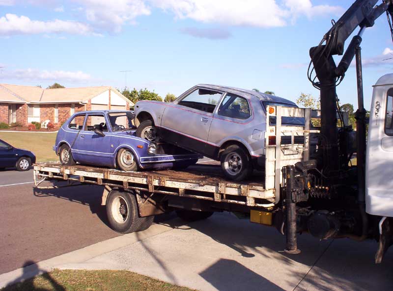

| By lazy (165.228.57.19) on Friday, July 16, 2004 - 02:24 am: |
I'll reply in chronological order...
Jonathan: The purple civic was full of rust. I think all that was holding it together was the chalky paint. The silver one was 95% rust free. And yes I stripped them of pretty much all useable parts. I wanted to get the whole window winder assembly, but have been very of late and since I've never done it before it would have been a complete pain in the arse to do anyway. The purple civic is sitting kinda low because I took the openable front struts off it

| By Kyle Thomson (24.83.12.187) on Thursday, July 15, 2004 - 06:55 pm: |
Well they look right hand drive, so I'm guessing its not seattle. It also looks like they both left with the hard to find right side mirrors
| By Dave (209.226.249.103) on Thursday, July 15, 2004 - 06:43 pm: |
Around here those would be considered an incredible find in that condition. Where are you? Seatle? I see so many civics on the net in that area.

| By Jonathan (68.193.10.141) on Thursday, July 15, 2004 - 07:55 am: |
Oh man, those two Civic looked totally rust free too! They're impossible to find in that condition by me! I hope they were stripped of all usable parts first?

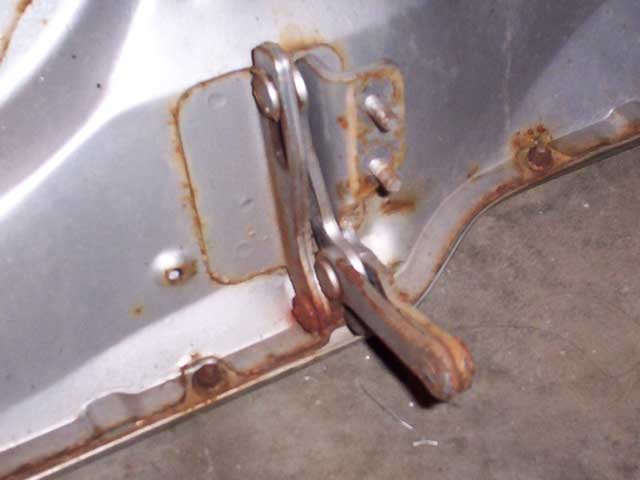

| By lazy (165.228.57.19) on Thursday, July 15, 2004 - 06:35 am: |
here's a pic of the '78 style hinge.
I have a spare '77 style bonnet and plan to cut off its hinges and weld them onto the '78
| By lazy (165.228.57.19) on Thursday, July 15, 2004 - 06:20 am: |
No, it is not a bolt on swap. On my '78 hood the fixing bolts are ~740mm apart from each other, whereas on my '77 hood they're ~712mm apart. The '78-79 hoods also use a different hinging mechanism which will probably interfere with your '77 grille (although I haven't tried). I think there has been a previous post about this.
