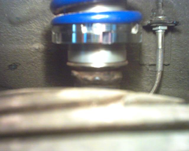

Heres what he means...
its soo easy...just chop off the perch with a hacksaw, make it look purdy with a grinder. Try and get a coilover set with aluminum top perches, mine are some kinda plastic...and I don't feel very safe with them...mabe they can be ordered from somewhere.
| By farenheight101 (24.69.255.203) on Monday, August 09, 2004 - 02:11 am: |

| By Jason (Roadwarrior) (24.69.255.203) on Sunday, August 08, 2004 - 03:50 pm: |
you can buy 88-2000 civic coilover sleeves, and slide them over the original shocks, but you will have to cut off the original lower spring perch, and install split collars to support the new coilovers.
this is what i have done, and it allows the car to drop to a 2 finger gap, and still have good suspension travel.
