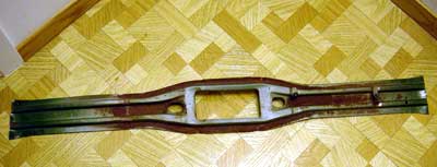

| By shreck (66.185.85.79) on Friday, October 15, 2004 - 07:10 pm: |
I modified a picture of my roof to demonstrate what to do. This is not the exact location as you are going to have to figure out exactly where to put it.

| By shreck (24.112.121.191) on Thursday, October 14, 2004 - 08:35 pm: |
Yep, extra rib, seam all the same thing to me. I still have the extra rib but no photos.
Check the photo to give you an idea on how it mounts in the stock location and just apply it to an extra rib in the forward location.
Instructions
When you go to the wrecker get the rib where the dome light goes.

| By shreck (199.243.98.218) on Thursday, October 14, 2004 - 05:51 am: |
You need the extra rib for the roof to mount it in front of the stock location. I went to the wrecker and used a wood chesel to get it out then you should use some kind of body sealer to help mount it. You might have to add a bit of sheet metal to the ends.
I had the same console and sold it when I found the proper one.
