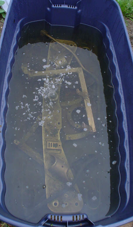

By Darrell--Arizona-- (68.109.151.121) on Saturday, October 09, 2004 - 09:34 pm:
I found some great stuff for Rust removal. I asked my chemistry teacher about rust removal. He couldn't give me any advice accept that he knew it had to be an acid. I went to home depot and bought two things CLR and Muriatic Acid.
The muriatic acid worked very well and very fast! I don't recommend this product unless you're going to water it down...heavily. I popped in some rusted bolts and within 5 minutes the rust was gone. Raw, pitted (from rust) metal was left, but it was rust free. The odor was very strong and didn't want to work with it again.
The CLR also worked. Because it was a weeker formula than the muriatic acid, it took longer. I soaked by strut mount for 1 week and it looked beautiful when I took it out. No rust and it didn't effect the rubber at all. I could live with the CLR odor...not too bad. The CLR is great for my schedule because it only takes a few seconds to drop a part in the solution. No sanding or sand blasting. It strips off the old paint too! I bought a plastic bucket with a sealable lid and put it in the back yard. A week later it was ready for me. Do not put bearings in CLR or Acid!
The CLR or acid will have to rinsed off. I think I can buy some paint prep stuff to wash off the acid without causing more rust, but I haven't tried it yet.
Hope this helps for removing rust.
