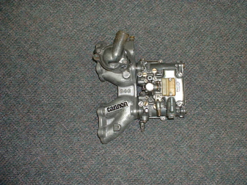

| By felipe casanova (200.30.231.18) on Tuesday, October 05, 2004 - 01:09 pm: |
whoa that`s nice pics!! but here in chile we don`t have the access to that manifolds, that`s why im asking if someone cut the original intake manifold!
how much cost a cannon intake plus shipping to chile
| By lazy (139.130.237.102) on Monday, October 04, 2004 - 11:15 pm: |
that's delish
| By Kurt (205.250.75.226) on Monday, October 04, 2004 - 10:59 pm: |
Cannon intake with side draft Dellorto DHLA 40
