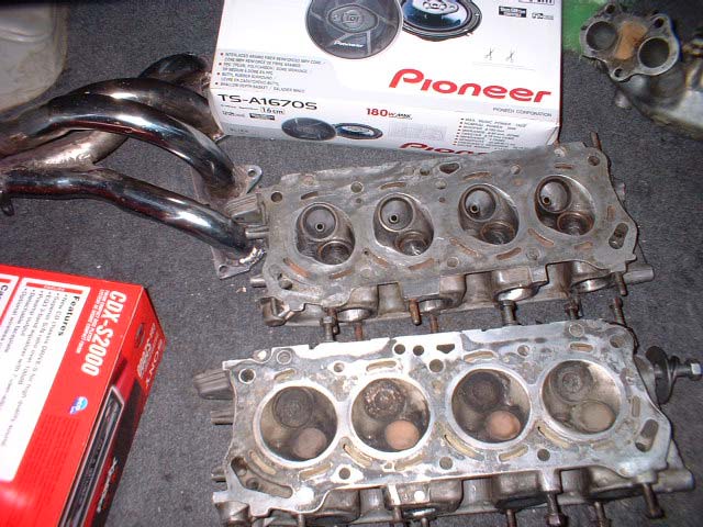

| By Don (199.2.139.174) on Sunday, October 03, 2004 - 05:51 am: |
With that set up that head will cost you power. Even John who races in GT and shifts at 10,000 RPM advises not to hog out the ports too much.
With your setup you will be much much faster with a properly done eb2 head.

| By Adrian (Evocivic) (203.42.97.141) on Saturday, October 02, 2004 - 05:18 pm: |
Looking at those pictures I'd say it's skimmed more than 3mm, and no it won't necessarily make your car fast. The ports look too big and you don't want them polished to mirror smoothness. What sort of cam, carb and exhaust will you be using with it?

well guys thanks a lot!!! so it`s an Eb-3 head! and yes is skimmed 3mm and with bigger ports and polished like a mirror! my car should be more fast with this head know
by the way i have to use a diferent head gasket right? and anybody know what`s ther diameter of accord pistons?

| By Adrian (Evocivic) (203.42.97.141) on Saturday, October 02, 2004 - 03:14 am: |
Looks like and BE3 that's had a lot skimmed off it (probably in the order of 4 or 5mm). It's also had a lot of work done to the ports.

| By felipe casanova (200.74.68.39) on Friday, October 01, 2004 - 09:44 pm: |
well guys here`s the deal, today my mechanic get this head from a friend, but we don`t know if this is from a civic(eb3) or an accord? we put the head on my block and fitted perfectly except for the head gasket the gasket left too close of the piston, well here is the thing i wanna know what head it is and what is the size of the accord pistons, oh i forgot the head has an h stamped and mine have an s stamped, well here are the pics my head is the round one, please help me soon i got to race the other weekend!!
