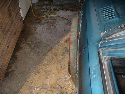

Oh, the woes of the sedan owner:( It throws a big wrench in the works to have the door sills so close to the fender. I'll have to find a way to work around it I suppose.

yeah man looks good i want to make flares myself. ill probably just add to the already existing fender.may be more stable. but yeah i was going to use sheet metal but the glass looks good too. i agree with makeing a mold. i would be down for buying a set

By farenheight101 (24.69.255.203) on Sunday, October 17, 2004 - 06:43 pm:
I'm not sure the offset of the wheels but I have 1" hub adapters. I had to move the fender lip out 5.5cm to match right up with the sidewall of the tire.
Is there a measurement I can make to calculate the offset for the mags?
Cheers,
Colin

By farenheight101 (24.69.255.203) on Sunday, October 17, 2004 - 04:52 pm:
Hey guys,
So I got a bunch of fiberglassing materials. Lots (4 yards of glass, 4 literrs of resin, etc) For $100.
I cut the original lip off the fender, right along the crease, cut about 1/2" off it to make look thinner, added some coat hanger supports, and taped it up. Now its all about wrapping it in 2 layers of fiberrglass before I bondo it and paint. Check it out though...first layer (not even) and it looks decent!
/image{frontview} /image{rearangle}
/image{rearview} /image{topview}
/image{setup} /image{setup2}
