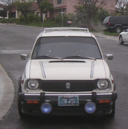

By sonymmx200 (208.54.15.129) on Friday, February 11, 2005 - 03:53 pm:
ok, one side photo also.
By sonymmx200 (208.54.15.129) on Friday, February 11, 2005 - 03:52 pm:
This is as close as I've come to making a Kamei dam fit my Civic. I purchased a 77 Accord Kamei dam, sold the car, modified the dam and now it's on my wagon
