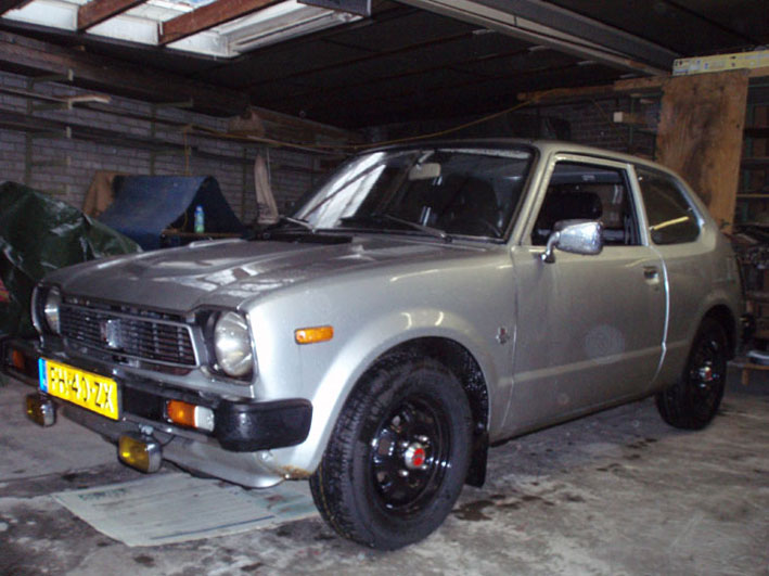

Yesterday I made a start with my project. It's a 1979 Civic 1200. I'm the second owner and I have the car for about 3 years now. It run approx. 95.000 km so far and runs still pretty smooth.

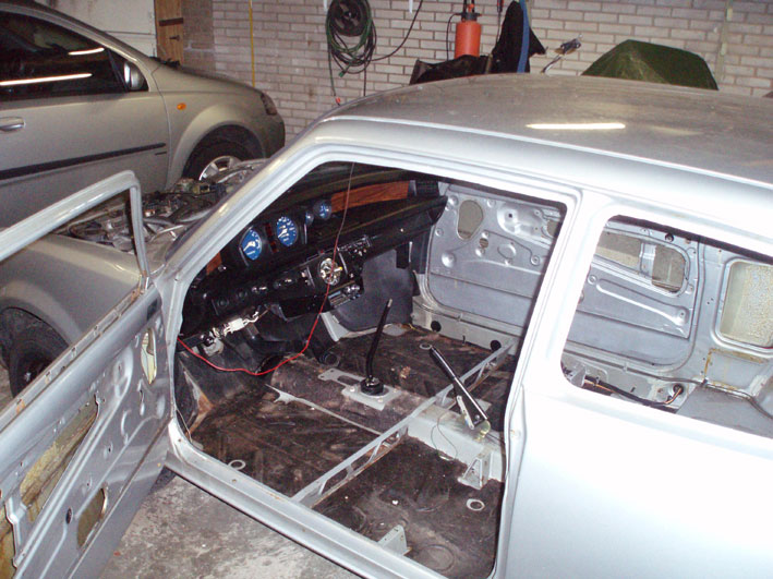

First of all I'm stripping the car down. Next week I'm taking the dash out and hopefully the engine as well. Since the car is at my grandpa's garage I'm not able to work on it through the week, but I'm not in a hurry.

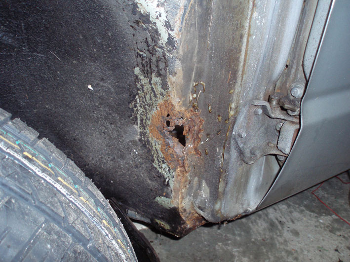

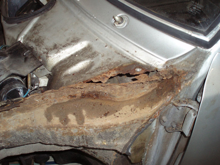

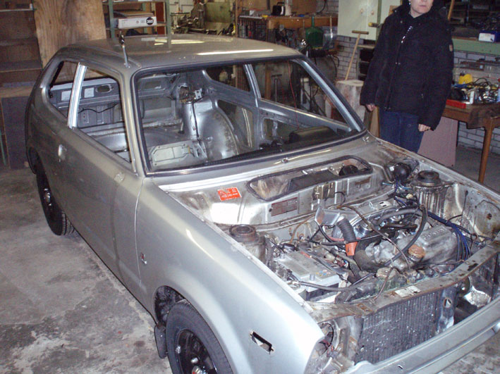

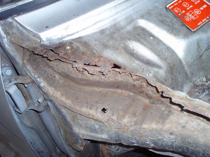

day 3...and here we have some rust...
Post by koosjer55 »
Couple of pics..

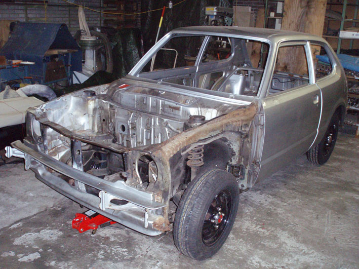

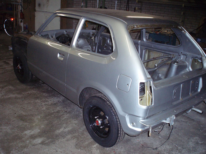

This Saturday, day 4, only 1 pin of the gearshift rod and I can pull out the engine.

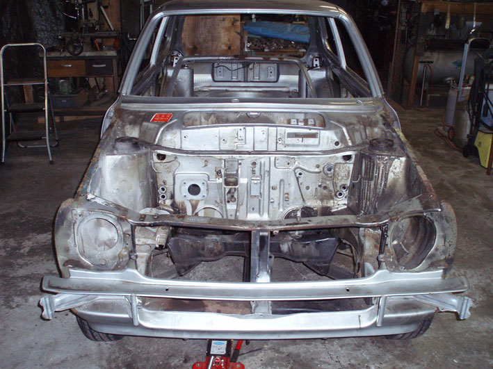

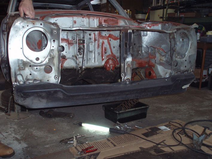

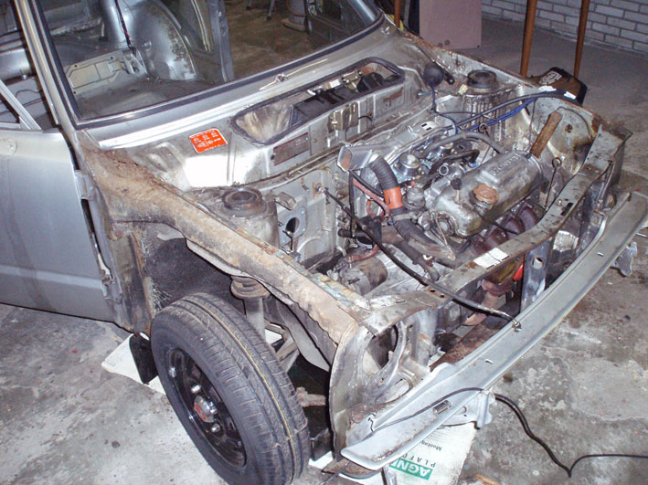

After removing the front fenders I found what I already did expect...let me call my welder!

Day 4 and the engine is out! Welding and sanding can be done soon, I hope (depends on my welder). What I want now is another tailgate, without rust. The one I have is reparable, but a rustfree one would safe me some time.

It's been way too long since my last update. As we say it over here in Holland: I haven't been sitting still :wink: Let these pics do the talking.
new lower skirt in place
it fits and next time this part will be finised

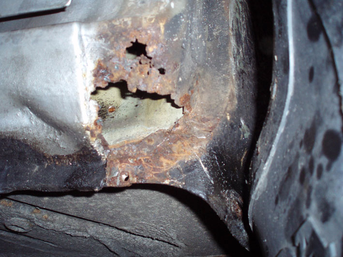

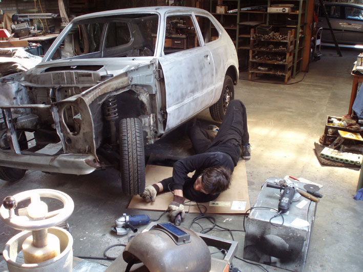

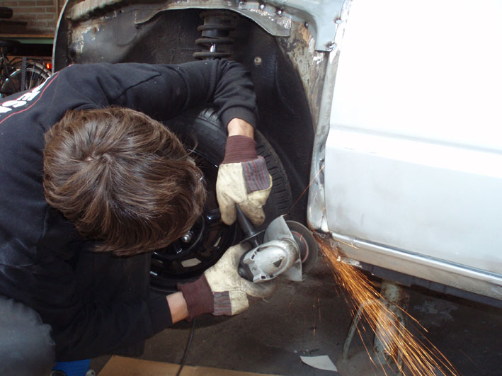

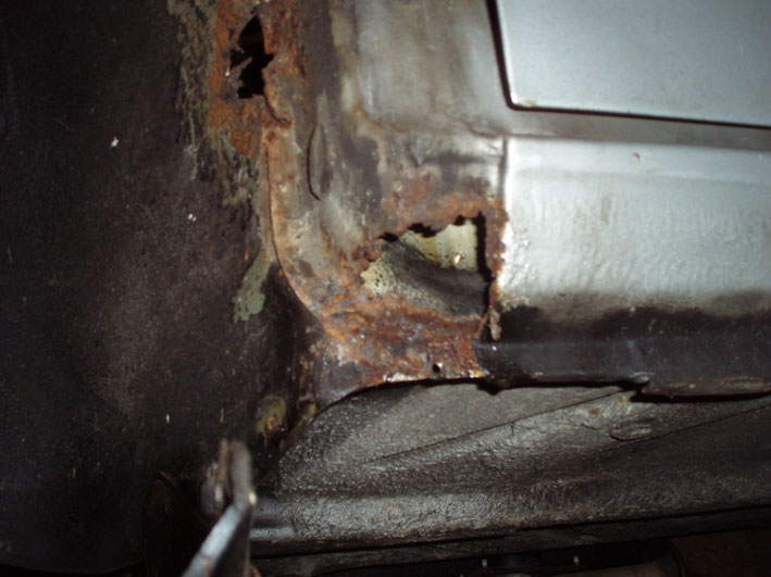

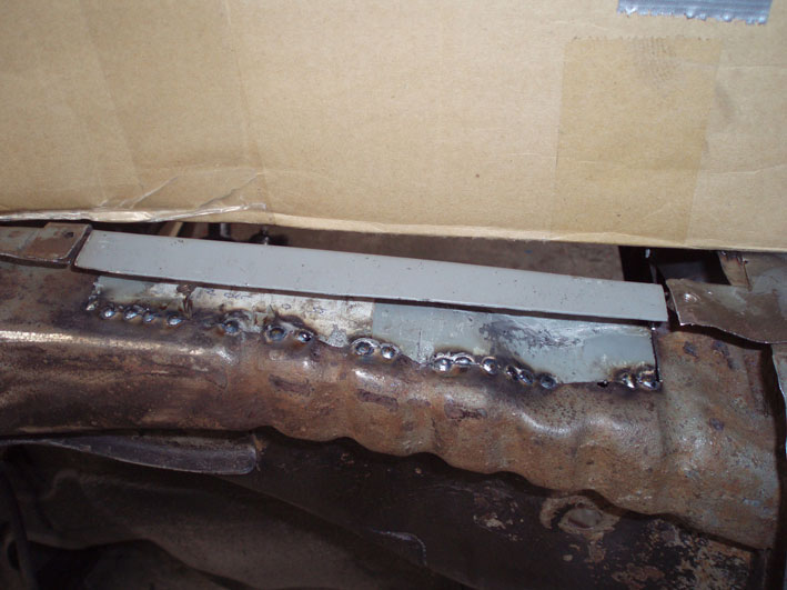

Rust all over the place...cutting and replacing is the only way
My buddy Dennis is the dedicated welder and grinder!

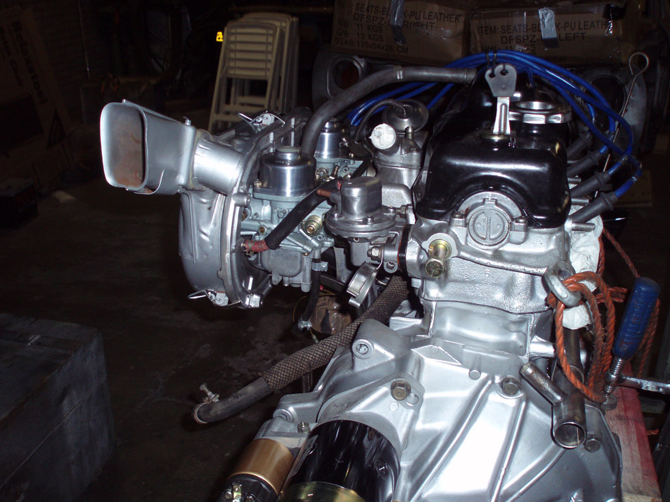

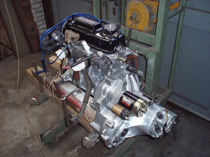

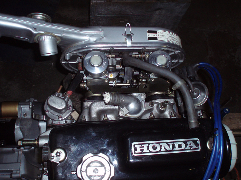

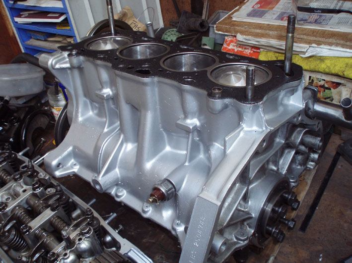

engine after..almost finished. Head is also "overhauled", as is the oilpump. RS carburetor are back on it soon. Electronic ignition is also on its way.

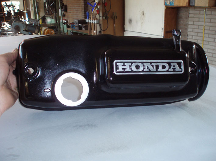

painted black (and grind the Honda letters..simple trick!)
back from the shop and venolia pistons are in
engine before
engine before

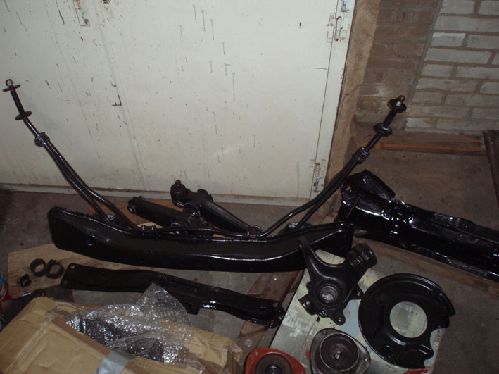

cleaned chassis parts and painted black with thick rust protecter. All moving parts have the Super Pro poly-bushings now.

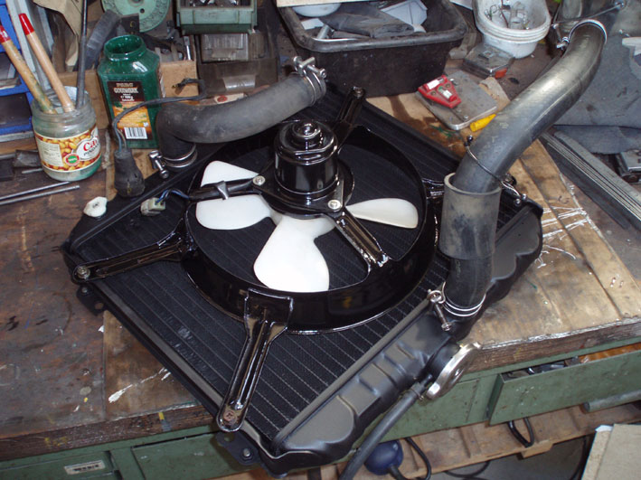

in the meantime I've refurbished the radiotor..now I'm this far, nothing escapes from refurbishing!

I did indeed replace all the bearings (in the 5-speed transmission as well). I buy almost everything via cmsnl.com. Engine parts are easy to get. The radiator paint is heat resistant paint from Motip. Should do the job. The fan has just been cleaned. I bought a standard used camshaft from somebody in Rotterdam. One day I'll probably replace it for a racing camshaft.

here a couple of pics with the RS carburetor installed
