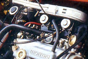

The RS is the ultimate factory Civic.
Dubbed Road Sailing, it was a more performance
oriented civic opposed to the standard economy-boxes we all know. It was released with an
1170cc EB1 motor pumping out 70hp compared to the 50hp of the standard model. Engine
modifications included twin Keihin carburetors, a freer flowing exhaust manifold, longer
duration cam (15 degrees), domed pistons (bumped compression up to 8.6:1), and
strengthened crank bearings. Handling was increased with a set of stiffer springs (30%),
shorter stiffer struts and 13" wheels wrapped in 155-80-13 tires. The wheels were
black with a polished lip and had a red "H" center cap- this is where the red
Honda "H" started. Besides the RS badge on the front grill other exterior
options included flared fenders, fender mounted rearview mirrors, and a slightly different
bumper assembly. The RS's were only released in warm red/orange paint schemes. The
predominantly black vinyl interior included a wooden steering wheel and shift knob, center
console, grab handles, a mechanical tachometer graded to 7k rpm, and a center auxiliary pod with
fuel/temp gauges and an air vent. The US gauge pods merely had the gauges for fuel and
temp.
