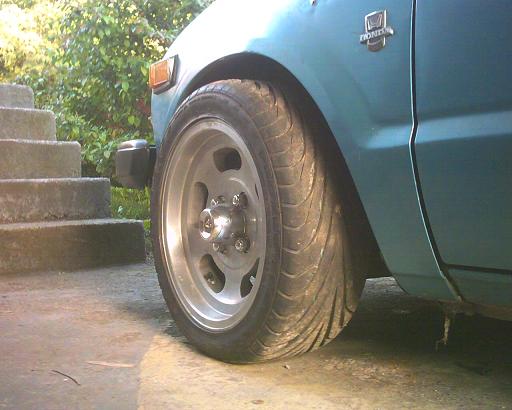

| By Colza (Colza) (219.88.30.79) on Friday, March 25, 2005 - 01:58 am: |
Those cheap kits work fine for what they are intended for, the reason i bought mine, and that is to make your car low and look good, but probably wreck your handling. I LOVE the height my car sits at now, and i think it handles MUCH better than it used to (body roll is a thing of the past) but it is very bouncy if you hit a bump and that can be quite scary at speed. I am prepared to accept that this is the way things are gonna be based on my current budget and available parts.
As for proper racing suspension, one day
but until then i can read this board and pretend. Hahaha.
